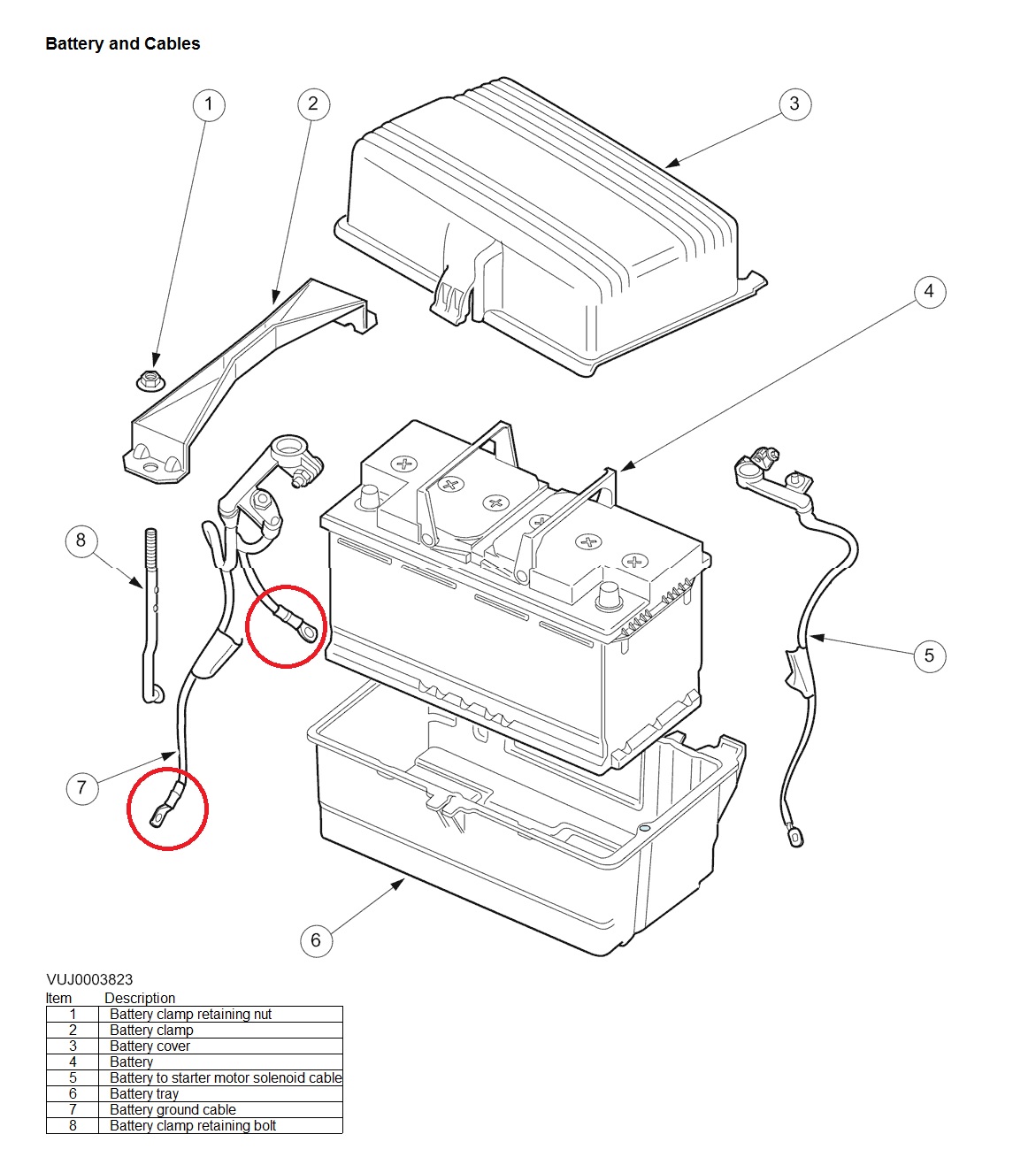

Apr 23, 2015 | 02:28 AM
If it's not the battery then the battery cables are a know issue.
The ground cable (item 7) has been reported to break at the connections circled in red.
