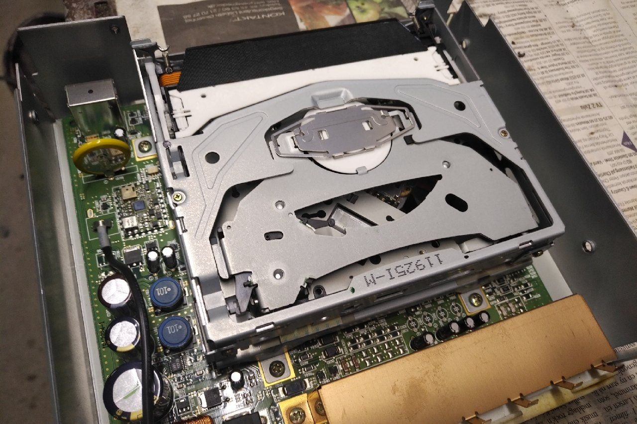

The GPS works most of the time, but when I had the X-Type in my workshop for thermostat, oil and headlight adjustment, I thought I'd look at cleaning as suggested. But how? Or where? I've taken it apart as much as I dare, frankly, if I take it more apart I usually ruin stuff, not what I'm best at. So any advice, is the place I need to clean even visible? Or?

The lens cleaning as described above is what I have done on CD / DVD players at home. The principle would be the same on the Jag CD player and nav unit.
But as I did not not yet have a failing Nav unit, I did not take mine... - well, that's not right: I did take one apart, but I can't remember the details. But I found this on the net, maybe that helps:
https://www.ifixit.com/Guide/Audi+Na...Cleaning/12404

If you are trying to clean the optical pickup, I suggest you use a cotton bud with either some eye glasses cleaning fluid or window cleaner.
Only apply the cleaning fluid to the cotton bud (don't try to spray the optical unit directly).
Use only very light downward pressure on the optical lens as it has delicate spring suspension to allow the focus and tracking coils to adjust the position of the lens.
You might have enough access to get the cotton bud to reach on the angle through the gap in the metalwork to clean the lens (part of item C) but pressure control might be more difficult.
If not, then you are probably removing the 4 screws (marked in red circles) which should allow you to disengage assembly A that limits the disc clamping arm.
With that removed, you can hopefully get some additional clearance now by tilting up B (if it is not being restricted by the disc clamping drive mechanism).
You should also see two small polished stainless steel guide rails that the optical unit traverses along.
They should be clean and not have any accumulation of dust piled up on the end of their travel in either direction.
If the optical unit has brass bushings, then a very light smear of 3in1 oil on each rail (less than a drop) if they are dry will help with smoother movement.
If it is just a plastic bushing then a fine white plastic grease is generally used.

Thanks, got it cleaned, very gently, so far it works fine :-)
