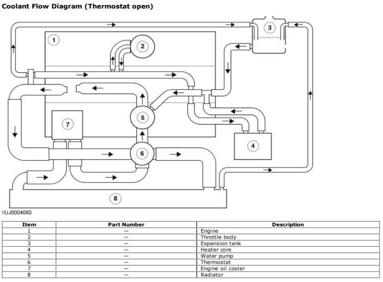

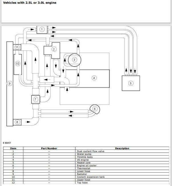

Now it's winter, and my preferred daily driver is the X-Type, 4WD etc. But...I lack heat.
The engine is a long time warming up according to the gauge. I have replaced the thermostat, the old one was broken in open position, the new is new, and just checked it, still like new. Takes 5-8 km before needle is in the middle. Normal?
Even worse in my climate, it takes forever to get heat inside. Even if I put it on HI, there's not much heat in the air to the feet. I think I've found the two hoses that run down to the heater in the cabin, filled with water hose to get rid of air pockets. I would like a schematic of the cooling/heater hoses. And now the tricky bit. This car was installed with Webasto heater from new. Doesn't work, wires just hanging when I got the car, so I'm slowly removing it. I know that part of what it does is heat water and circulate to cabin, maybe now it stops circulation. So I need a schematic of the original hoses so I can spot the perhaps not WAD part. Currently, when car warms up in garage, all hoses get to be hot, except the two going to the heater

I think I've sorted the second half of my issue, after a pressure hose through the loop to the heater, a clogg came out I think, freer flow and the hoses themselves hotter to touch. So enought heat in the cabin, good.
I still think it's very very slow to heat up, the engine, despite new thermostat. Compared to other cars (and if gauge is of value), I have to drive twice as far...
