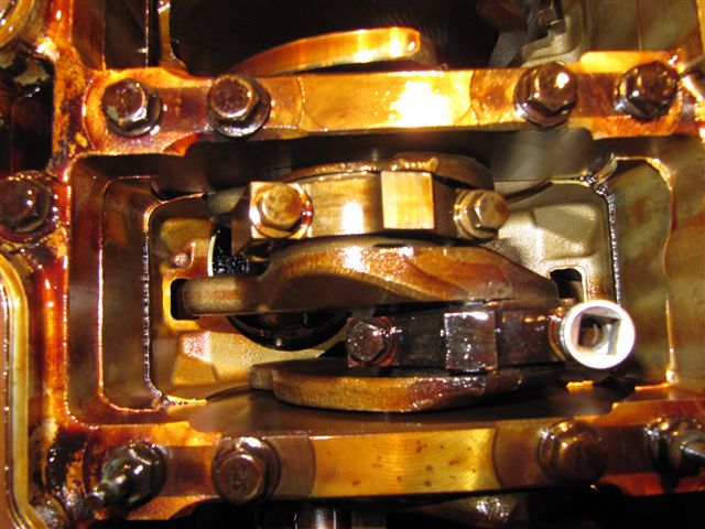

A little back ground first. I purcahsed this car with a spun rod bearing beacause it looked like a good deal on a nice car with a problem I could fix, with in the, worst case a replacement engine. After removing the engine from the car and opening up the bottom end I decided to repair the enginer by rebuilding the bottom end. Thus I replaced the damaged rod had the crank ground installed new rod and main bearings and a new oil pump. I had to remove one head to replace the rod but other than this left the top end of the engine alone with the exception of inspecting a couple of the cam bearings on the head I didn't remove to see if there was damage to the the cams or bearings.
Now the engine is back in the car but after idling for a minute or two the oil pressure begins to drop as the engine warms up. I suspected a lack of oil pressure because of the way the engine sounded as it warmed up and the oil light started to flicker a bit. So I pulled off the oil pressure switch and connected a temporary mechanical oil pressure gauge to monitor the pressure.
When I start the car cold the oil pressure starts at 50+ psi and drops to about 30 psi by the time the fast idle ends. From there the pressure drops slowly over the next 5 + minutes to about 5 psi where I shut it down. I didn't have my watch when I ran this test so I'm guessing at the time involved.
I plasticgauged all the rod bearings so I'm confident in their bearing clearance. I didn't mic or plasticgauge the main bearings but don't have any reason to believe there is a clearance problem. So I'm stuck wondering where all my oil is going as the engine warms up. Any ideas would be greatly appreciated.
