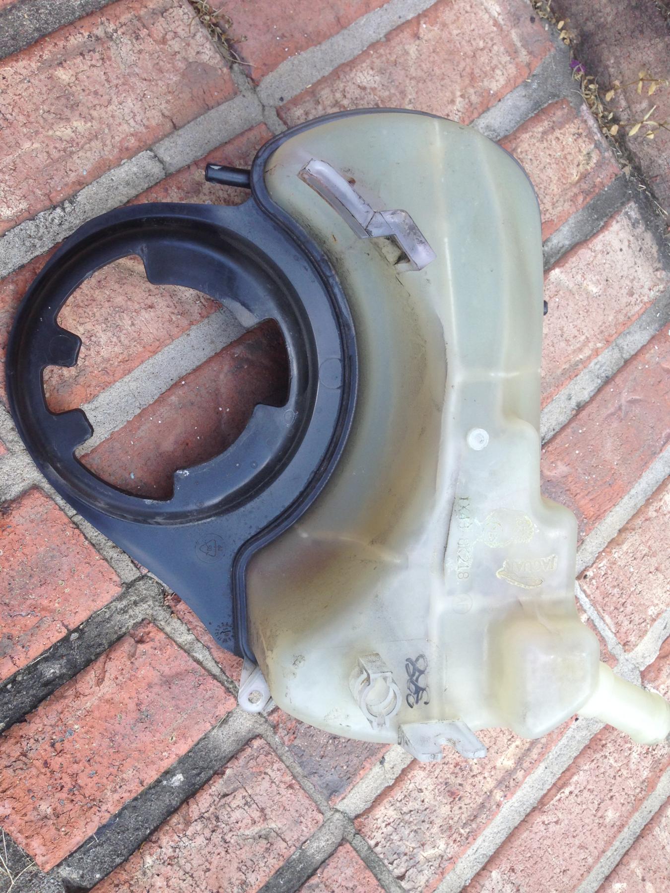

Thanks to all your posts, which helped me find and fix a leaky coolant reservoir in my 2002 X-Type w/ 125 Kmiles. Hoping to return the favor, I've attached pictures of the stress cracks in my old reservoir - they are the dark lines in the otherwise white plastic. Look closely and you may even see dried coolant on the part number 1X43 8K218 and the Jaguar logo. FYI, the Jaguar part number is C2S 46861 or C2S46861.
The leak was slow, maybe a cup of coolant every 300 miles. It leaked only when the engine was hot, i.e., with the coolant system pressurized.
Your posts helped me diagnose the source of the leak:
1) Not the water pump: The leaked coolant collected near the firewall on the top of the transmission. If the leak was from the water pump, the coolant would have gathered under the battery, towards the front of the engine compartment.
2) Not the 3 hose connections to the reservoir: After a long drive while the engine remained hot, I carefully used a dry paper towel to touch the reservoir under all 3 hose connections. The towel remained dry, confirming the leak was somewhere else.
3) Bottom of the reservoir: So with the engine still hot from a long drive, I carefully reached under the reservoir with a dry paper towel. The towel became slightly damp with coolant leaked from stress cracks in the bottom of the reservoir. The leak was minimal, just enough to moisten a dry paper towel.
$39 for a new reservoir on eBay, and we're back on the road without leaks. I would not trust a use reservoir since older plastic is more prone to develop these stress cracks.
Thanks again for all your posts - they helped me find and fix this leak. Hopefully the attached pics will help the next person find and fix it even faster.

Folks,
Problem Solved!
Tremendous advice which is greatly appreciated.
It turned out that the winner of the most correct advice was "dwclapp" as the culprit was a cracked coolant reservoir.
The cracks were on the bottom of the reservoir, so I was unable to see them.
Strangely, I didn't notice any signs of the leaking coolant, but that was the problem.
Thanks again to everyone for the suggestions (and especially to dwclapp with the posted pictures).
