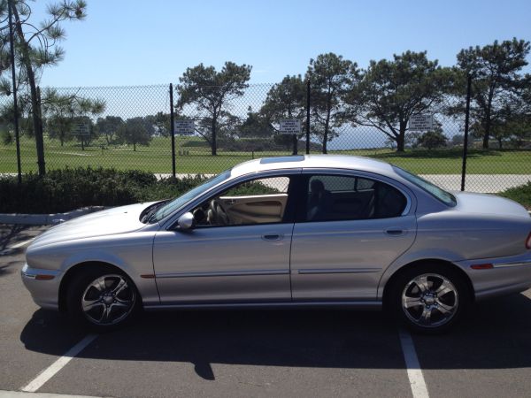

Just bought a 2002 Silver X-Type Sport for my daughter and she is loving it. She says its getting her all kinds of attention
Anyway, while it has only 67k on it, there were a couple of issue to take care of:
Heater vent on the dash had popped off due to dash vinyl warping - I glued it down with a bunch of GOOP and found that a couple of tennis ***** work great to wedge down the grille while the glue is curing - can't tell it was ever warped now.
Ashtray cover would not latch closed: After taking it off, I found the latch pin was out of the slot. Carefully levered it back in and now the cover latches closed again.
Clicking sound at J-gate whenever the brake was pressed. Based on a tip on this forum, I took off the cover and j-plate and opened up the micro-switch for park. The contacts were corroded and not completing the circuit, but just cleaning them fixed it. (Be careful not to dislodge the rocker bar- its so small it's a bear to re-install). That stopped the clicking.
Front speakers on Premium Alpine sound system not working. After disassembling following advice on this forum, I found the braided wires in the speaker were corroded through where they are glued to a support bar. I solders a light wire across the bar and Presto! both speakers now work. (Manufacturing defect by Alpine - the epoxy they used corroded the wires - probably happens a lot in these cars).
Now the only thing missing is the Leaper! maybe that will be this year's Christmas present!
