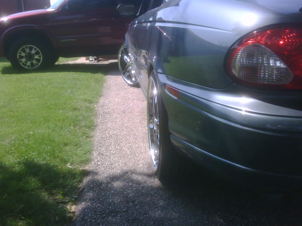

heres the best pic i have showing the strech

Yep, not quite as aggressive as the 20x9s I have with 225/30, but respectable. Rears camber in as you go lower, so nothing to worry about there if you aren't rubbing now and you'll still have gap in front, so I still say you chop half a coil from whatever end is not pigtailed.
