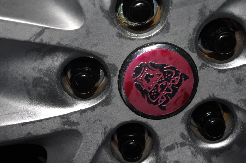

Washers suitably seated. The marks are grease not dirt.
