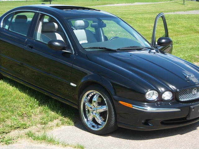

redline is bullet proof i use it in my rx7 turbo
dynoed at 437hp on my stock tranny..i race it at english town
i use it in my x-type
