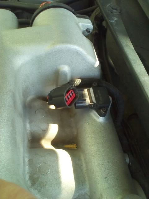

thanks Thermo, I did clean the throttle body once, but I used maybe 1/4 can of throttle body cleaner. I thought about taking the throttle body off and cleaning it and the intake manifold. Not sure, but I bought a TB gasket when I was at the dealer Friday in case. Speaking of the dealer.... I got the car home (running like crap) parked it, then I went out this morning to get a look at the throttle position sensor, and the thing on the opposite side of the throttle body, the actuator? In any case, when I opened the hood I saw the following:
The Jag tech left this unplugged! They were of no help anyway, I felt like I paid $115.00 for a car wash. (when you take your car in, they wash it b4 they return it as a courtesy) Does anyone know what this plug/sensor is called? I am going to call the dealer Monday and ask for my money back. If the tech left this like that, I wonder what else he left unplugged, or if he knows what he is doing! It'd be good if I know what this thing is called. I work 9-5 so I'll have to deal with them over the phone and I'd like to know the name of this. Thanks guys!

That looks like the Intake Air Temperature (IAT) sensor. That would cause the car to run a little rough. That is used to help compensate for the amount of air going into the engine.

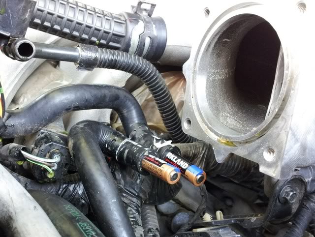

The new throttle body fixed the problem. For my troubles, it was $1,000. The side you're seeing is the side you never see unless you remove it. Notice the 2 cooling line nozzles and the shiny new butterfly valve. On the left we have the black Actuator, and on the right side is the tps or Throttle position sensor. In black.

It brought my Jag back to normal, and dare I say the acceleration is somewhat more accelerated. I tried everything else before I paid for a new TB, but in the end there was no getting around it. As I mentioned earlier, I had a leaky upper radiator hose, and after fixing that, I got the crazy idle and jerky-ness when decelerating. I had no vacuum leaks and cleaning my TB did nothing to help. But my coolant was leaking about a quart a week, and I let my plastic overflow reservoir get lower than minimum pretty often. As long as the temp gauge in the dash read normal, I figured the engine is cool and everything should be good. But I drove it with a low level of coolant in the plastic reservoir rather regularly for 2 months. This may have led to coolant not getting into the throttle body the way it should, and caused it to run too hot. Considering this TB had 100K on it, it may Not have liked the heat and so the electronics may have failed due to a sustained rise in temp. Even though, my engine stayed cool, there is no throttle body temp sensor; or is there?
The whole thing may have been my fault, ...this is just a theory. In any case, I used AAA batteries to block the coolant lines while I had the TB out. They fit perfectly; I read it here...
This worked and now the new TB is in and serving well.
