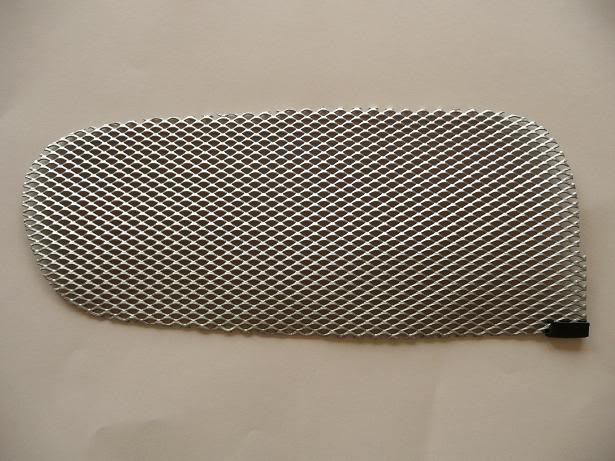

I bought one of these mesh grille kits from ebay. Price was 45 pounds (about US$70) + postage. I was a bit surprised to see what actually gets sent...
...two of these.
They are basically just 2 pieces of aluminium mesh cut out using a stencil with a small piece of sticky tape stuck to one corner. The mesh is soft enought to cut with garden scissors and seemed to have been done in a hurry with rough barbs and edges all the way round.
You can buy 1 metre sheets of aluminium mesh for a few pounds and the seller could get maybe 3 sets of these stencils from one sheet so raw material costs for one set could be as little as 2 pounds. To then sell them on as specialised parts at 45 pounds seems bit of a rip off. The items are cleverly displayed in the adverts already mounted inside the grille assembly so you cannot see how simple the item is.
The instructions that come with the item are not very good either telling you to buy a Pozi-drive screwdriver when it is in fact a Torx screwdriver that you need. I found the FAQ thread posted by nineball to be much better.
https://www.jaguarforums.com/m_18238/tm.htm
If anybody is thinking of doing the grilles I would suggest just buying the mesh and cutting it out yourself. I will post the exact dimensions when I am back home at the weekend.

To the original poster: I'm sorry to say this, but you did get ripped off
I bought the Minagallery mesh grille. It was about the same price on Ebay, comes in one piece, and is formed in three dimensions (i.e., it's not just a flat piece of mesh - It's actually contoured to match the shape of the grille opening).
It's also heavier gauge plated metal and has a much richer diamond pattern than the one in your pic, and nicer even the OEM Jaguar grill. The only downside is that I had to trim the edges in a few spots to get it to fit. I had to use a power cut-off wheel to trim it, because wire cutters and scissors couldn't make a dent in the thick gauge metal. I was pleasantly surprised by the high quality of the Mina Gallery grille, despite this minor inconvenience.

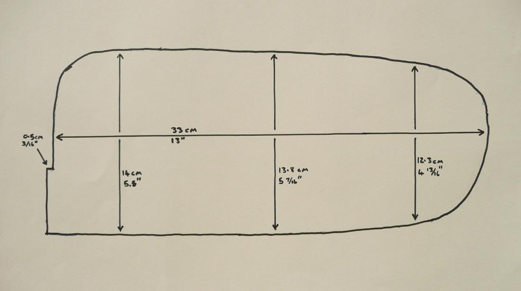

Here are the stencil dimensions.
If I go ahead and try this I will post a thread on the process. Not sure whether I will bother using these bits though. The chrome plated wire mesh in 3 dimensions from Mina looks a lot more professional for the same money.

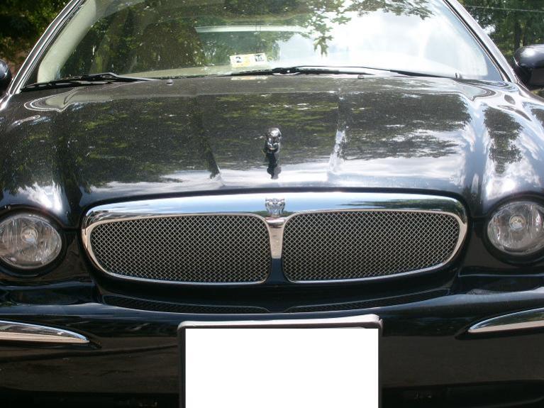

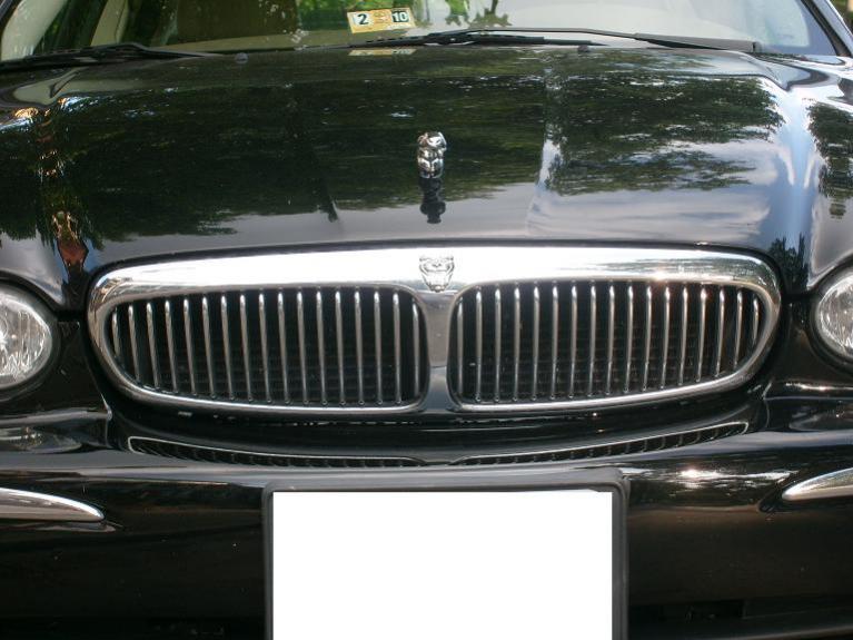

I installed mine yesterday and love it. I HIGHLY RECOMMEND going with the Mina Insert. It's what you're looking for defintiely. The quality cant be beat. Installed and fit perfectly. It took about an hour and a half. You'll definitely need a jigsaw or dremel, so dont start without one.
Some notes about installation:
1. as not shown in the above instructions, before undoing the tabs to remove the back, remove the hex bolts first, then pry the tabs apart to remove.
2. with a jigsaw or a close cut w/ a dremel, you wont need to file down anything. Be careful, I almost took off my arm a few times with the jig. There's lots of vibration going on around the end cuts and it can get away from you.
3. as not shown in the above instructions, you'll need to cut off the front "supports" on the surround that stick out. There's a few round ones and quite a few rectangular shaped ones. These will stop all the peices from being flush when reassembling. I used wire cutters for this and they worked great. No need for a power tool.
4. take your time and use some common sense. This isnt a 10 or 15 minute job. It's easy, but expect it to take between an hour or two.
Check it out:
