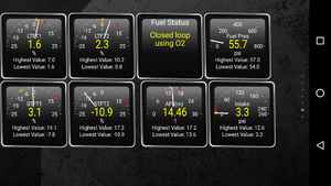

I have not so long ago bought a Jaguar X Type 2002 with 175k kilometers on it.
When I am uphill or when i try to kick the foot on the accelerator I have misfires that seem to almost totally turn the engine off. Also the engine seems like it is struggling.
The misfire happen from 1.5rpm to 2.5 (not higher).
Also I never have any check engine light since the number of misfires never reaches the threshold I imagine.

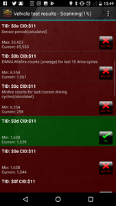

Diagnosing with torque pro (such a pity we don't have the PID-s of Jaguar) I did some tests of fuel trims and as well some tests.
Can't determine what bank the problem is happening. I notice though the long term fuel trims are high (+6 bank 1 and +9 bank2) when on idle.
Attached are some pictures of my torque and also the results of the test from torque.
What do you guys suggest to do further?
Pic 1: Idle
Pic 2: At 2500 rpm
Attached Thumbnails Misfire when on Load-idle.png   Misfire when on Load-2500-rpm.png   Misfire when on Load-screenshot_20171210-134907.png

That's often a coil. They're under extra stress in exactly the situations described.
Bear with me - it could be a battery problem instead. Sounds wacky but the big fast current needed for the coils comes from the battery. (The alternator recharges in a more steady manner.)
Sorry to give you two possibilities.
Those idle trims are a bit high. If you see those then rev do they quickly head nearer zero? If yes you have a small air leak. (I suspect as well as any coil issue.)

The Idle trims are displayed in picture two when i rev to 2500rpm. They don't really go to 0. Also might be a air leak since when I drive in 5th gear only above 80kmph i hear a whistling noise coming from the front of the car. It might be the air leak that whistles. What would you suggest for diagnosing the airleak.
