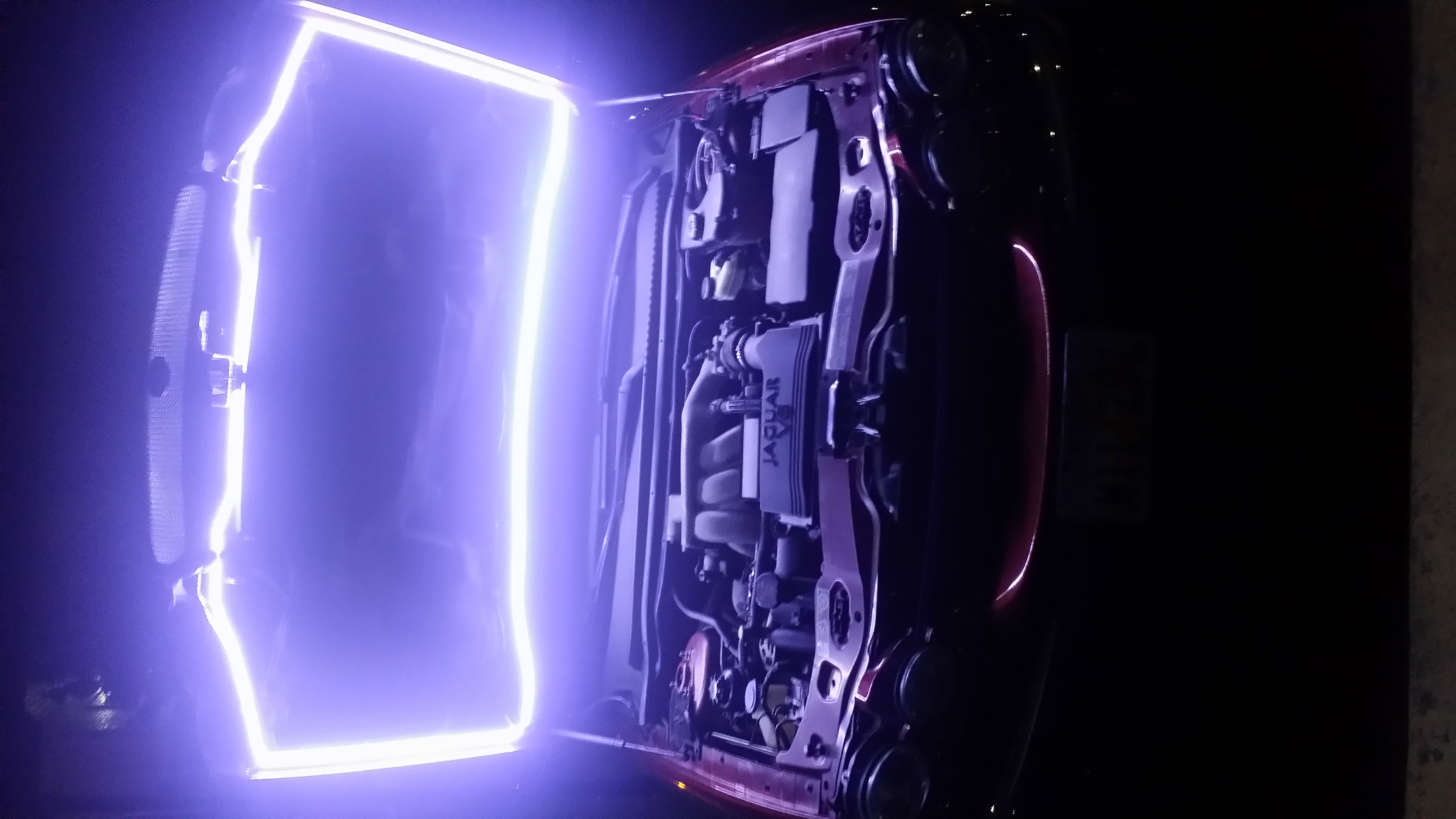

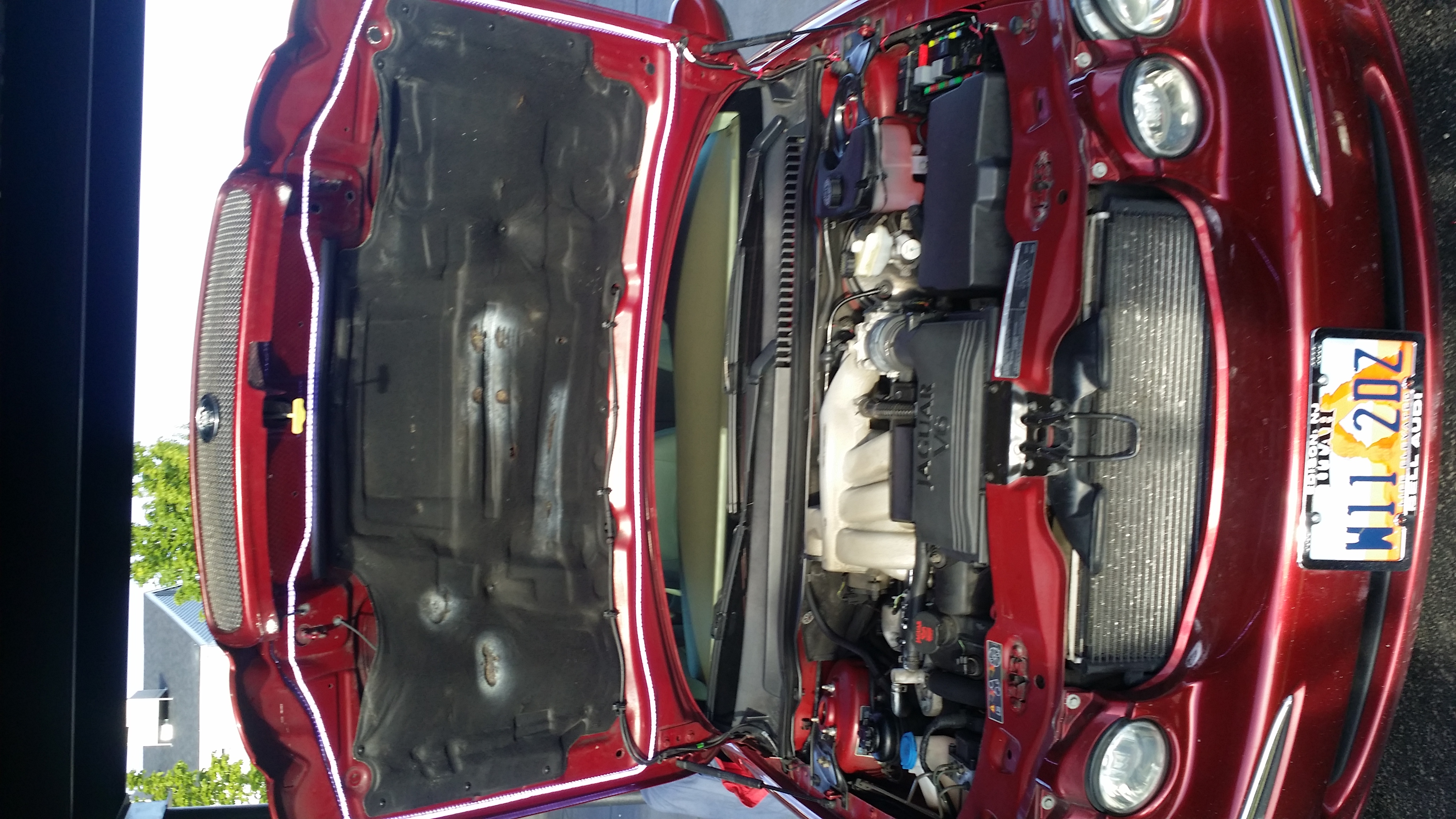

Engine bay = I can now see!!

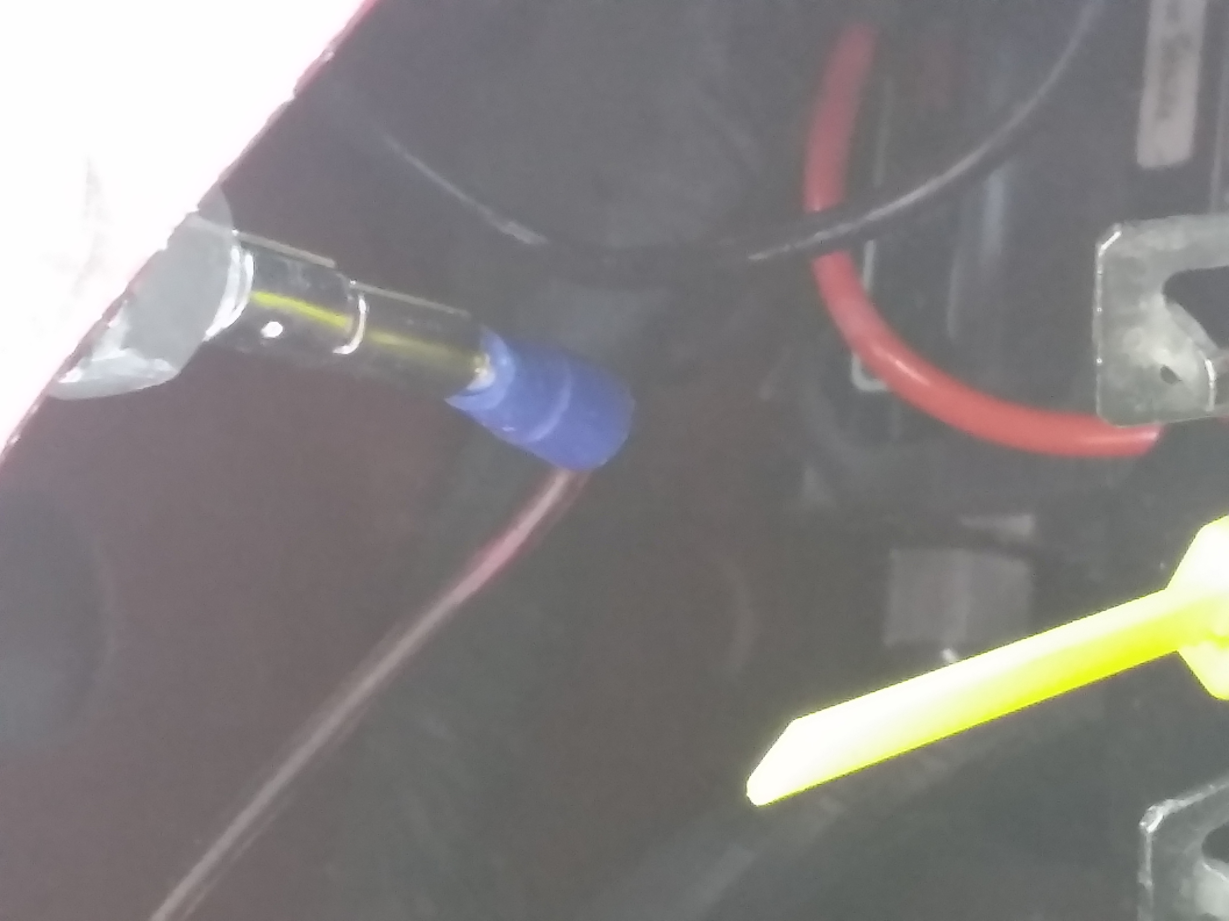

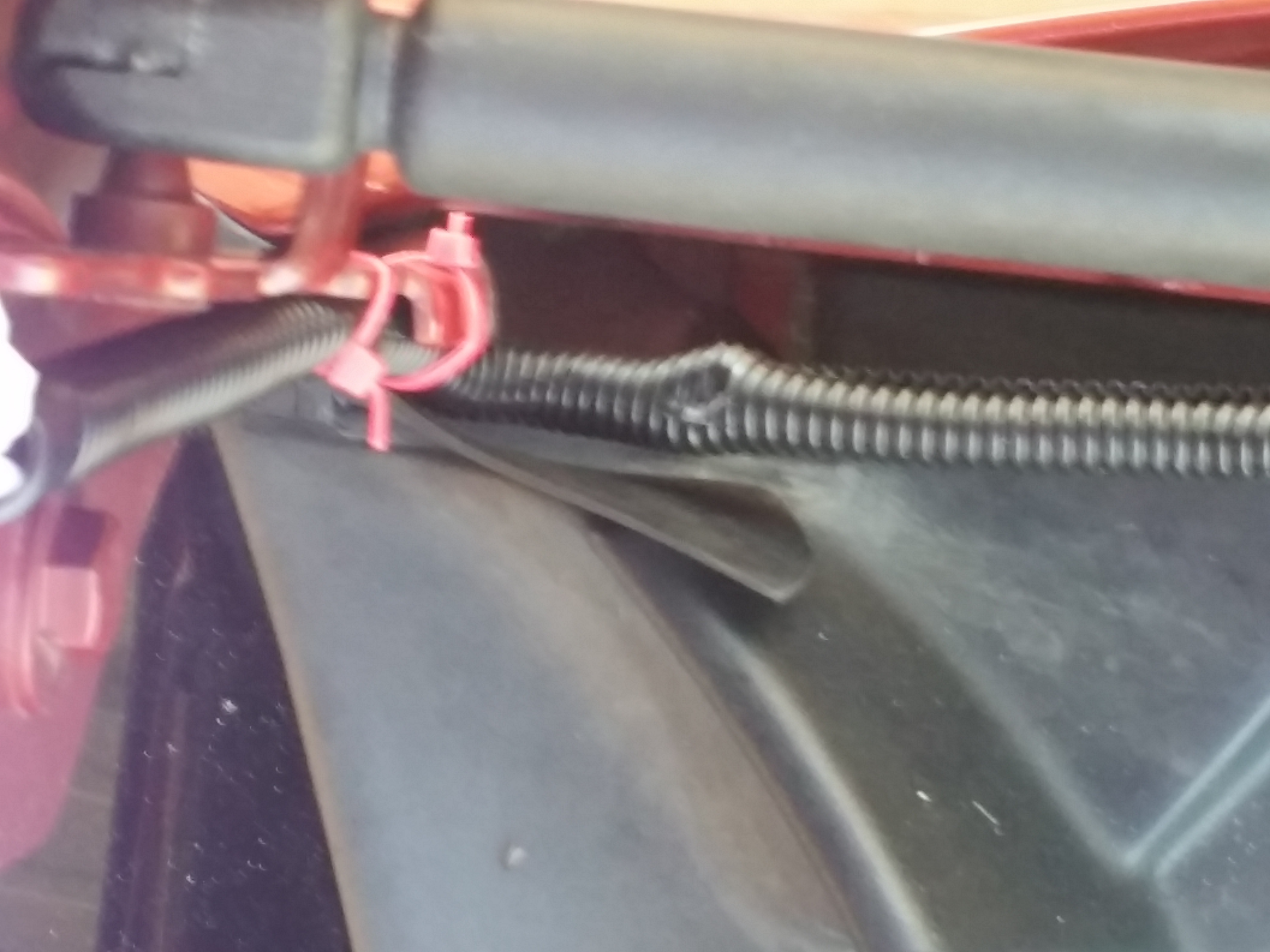

Then bought a door hinge pin, drilled a small hole just to the rear and slightly right (looking from front of car towards engine bay) of the driver's side adjustable hood height pad in front of the fuse box. Ran power through small drilled hole in fuse box, up under the slight protrusion of driver's fender to lights, return ground from lights to door hinge pin for hood close light cut off. Checked mounting height of pin with a little molded piece of "play dough" to assure mounting height.
