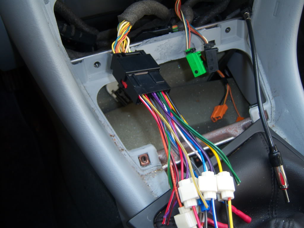

use this wire for the illumination of your deck ...the orange wire from the nexxia adapter is for the dimmer and does not carry a full 12v
