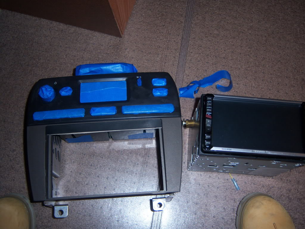

if the deck powers up it not the hot wire....did you connect the grey and white wires for the speakers? or did you use rca's
is this the adapter
is your wiring like this

Soldered the speaker wires, each match up. Yes the same adapter PC2-81-4. The deck has bluetooth, so i connected the blue/ blk tele mute also.

try and disconect the blue/black wire and see what happens ..do you have a amp

Thank you for the help. Worked like a charm.

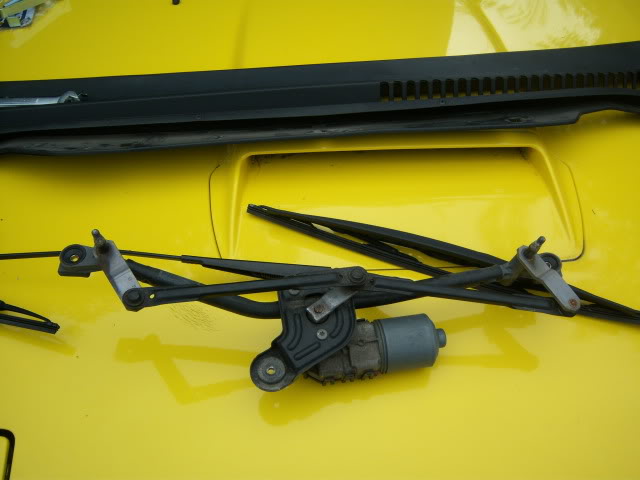

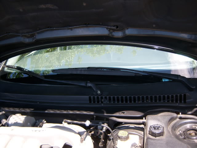

Default wiper delay fix
if when you put your wipers in auto so it has a delay ...it just goes in one mode or stop half way on your windshield! heres the fix..so i can save you guys some money and diy
1..first you will need a a gear puller ...13mm socket
2..on your windshield wipers you will see a plastic cover flip it up with your finger ..so it can expose the 13mm nut you are going to take of
3..then after taking nut off, put your pulley on it and remove both wipers
4..now we have to remove the cowl ,there are about 6 plug fasteners use a screw driver and pop then out..now remove cowl
5..now you have removed that, while were at it change your pollen filter

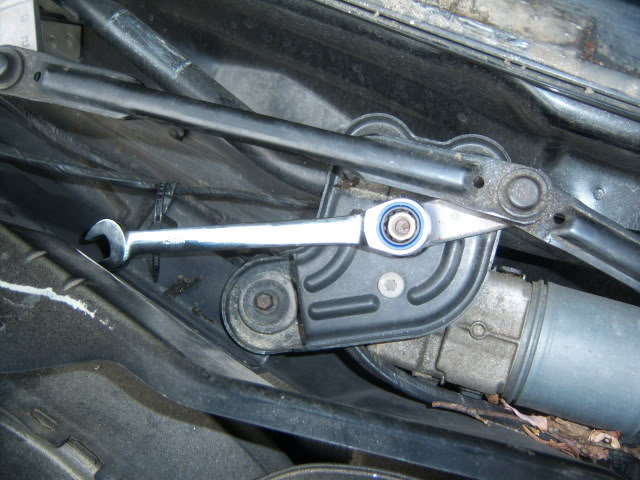

6..now remove the 3 13mm nuts and pop the whole assembly out
7..now these are all the items you should have removed

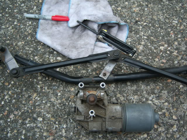

8..now transfer the knew motor to the wiper assembly
9..button it all up your done

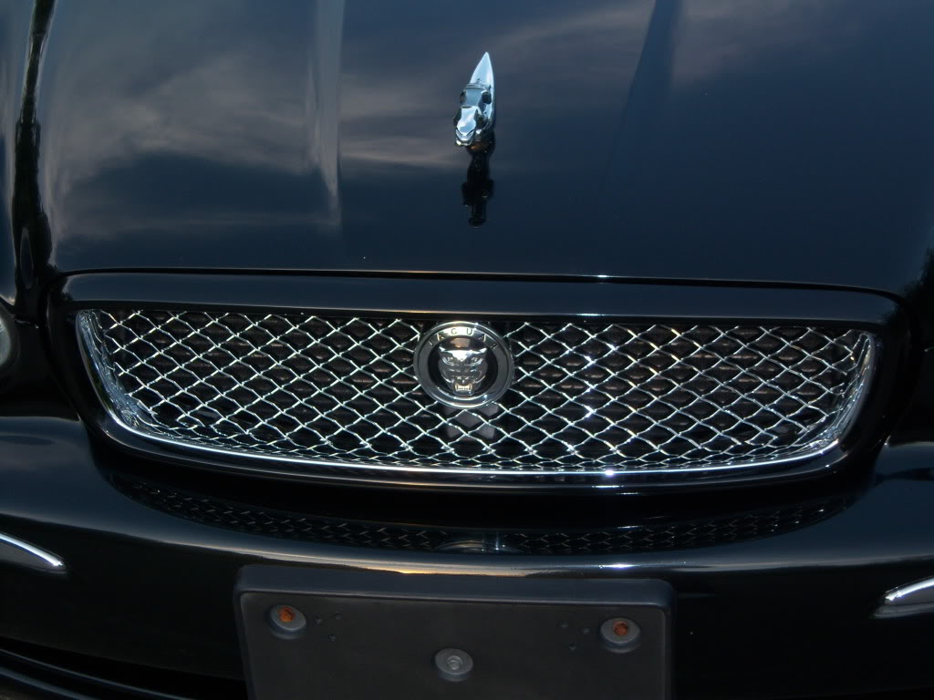

Not the best pic, but here's my new grill. I love the thing!

yeah, you give them the paint code from inside the door. I didnt do a price comparison with mina because I liked the convenience of having it already painted.

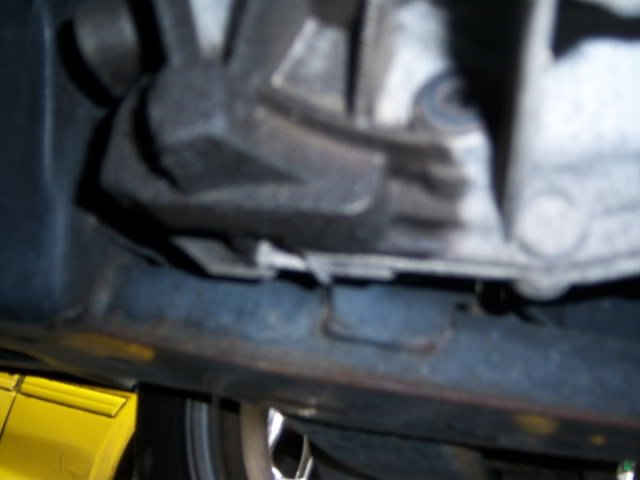

7-look to the rear of your transmision and locate the 5/16 plug

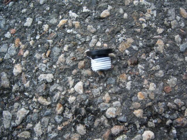

11-put tape on the threads on the plug and button here up your done
