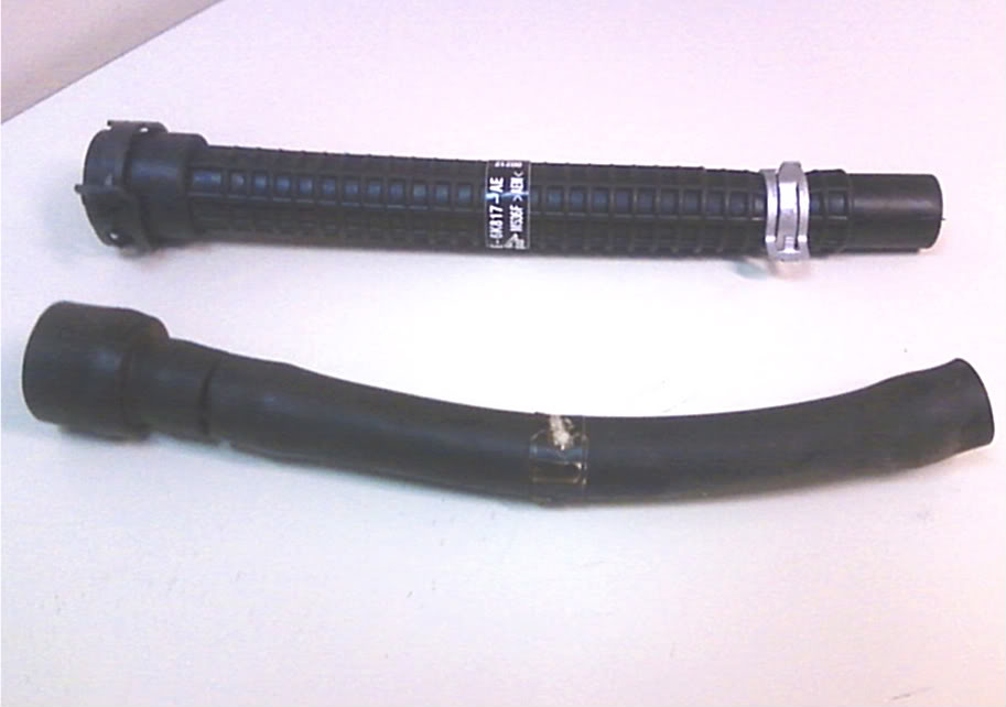

Hoping someone can help me? I just called for a part and the guy wasn't sure what part I needed does anyone know the correct name for this part small hose in the engine compartment that had a split in it, you remove the cover and looked in the middle you see that hose, what is that hose called besides a pcv hose? Thank you

A pic of the hose could make identification a lot easier ..........

Does it look like the attached image (the old hose is the bottom one, the newer design replacement the top one)?
If so, the part number is C2S40863.
Here is an example on ebay: Jaguar x Type Emission Crankcase Control PCV Valve Hose C2S40863 | eBay

If you have the one on the bottom make sure you replace it with the one on the top.
