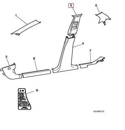

This is the EPC diagram for the post trim:
JAGUAR X-Type - C Post Trim.pdf
It's an unusual way of listing B and C Posts which could explain the difficulty you've had finding the part number.
Items 3 and 4 are both described as 'B/C Post Finisher'. The part number is then both VIN and colour specific.

The Part Number depends on VIN and Trim Colour.
Item numbers refer to the drawing in post #2. Item 3 comes in Nimbus Gray, Oatmeal or Sand. Item 4 comes in Dove, Ivory, Sand or Warm Charcoal.
Driver's Side = Left Hand. Your VIN falls within the range:
Item 3 to VIN C65824
Nimbus = C2S19360LFJ
Oatmeal = C2S19360AGD
Sand = C2S19360ADX
Item 4 to VIN C65824
Dove = C2S11236LHJ
Ivory = C2S11236NED
Sand = C2S11236ADX
Warm Charcoal = C2S11236LEG
The 3-Letter Trim Code for your vehicle should be on a sticker on the driver's door post.
