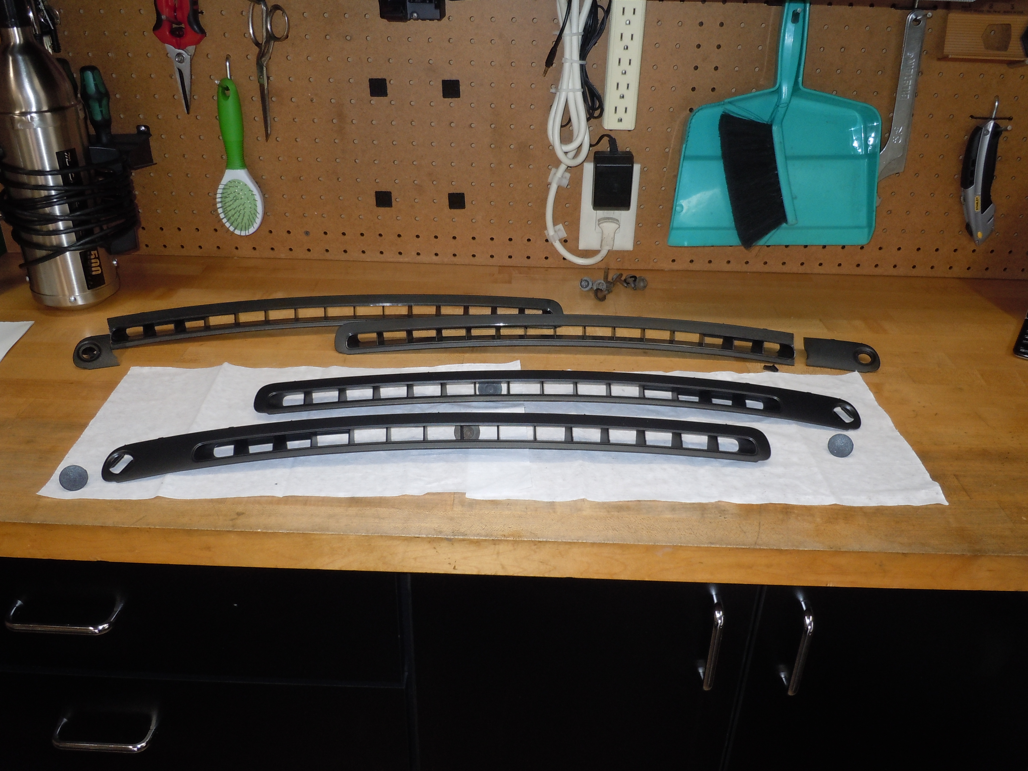

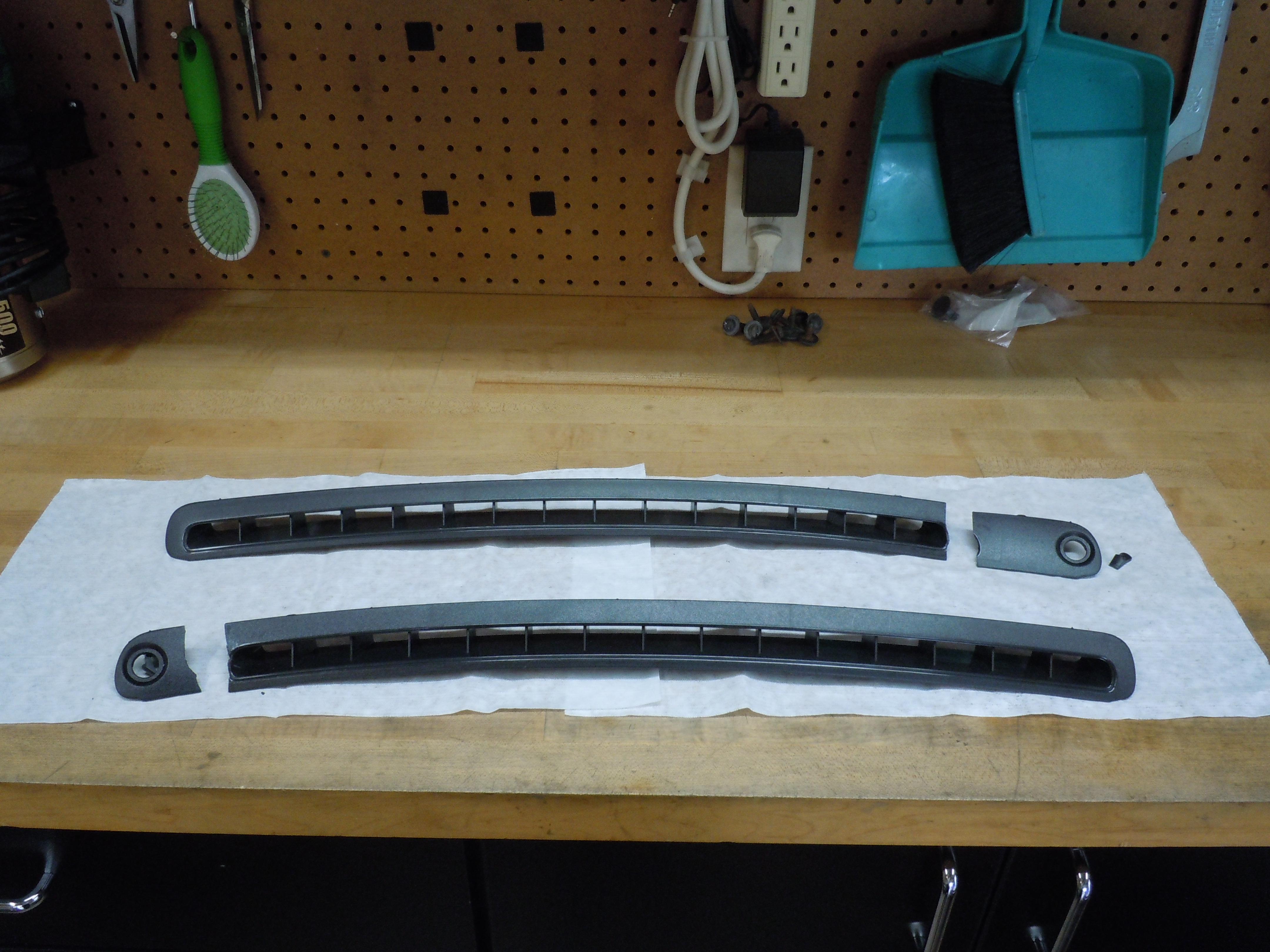

+1 on looking at SNG Barratt's website. These grilles are common failure items because of sun exposure. Part numbers are C2S43948 and -49, but there's also a suffix on them for interior color. Same suffix is on the Blanking Plug that holds each grille down. Your interior color code is on the identification plate on driver's door jamb. The colors are Granite (LGP), Mocha (AMB), Oyster (AMT), Sable (AEK) and Warm Charcoal (LEG). If you get new grilles be sure to get new blanking plugs.
SNG Barratt - The Ultimate Jaguar Parts Specialist
