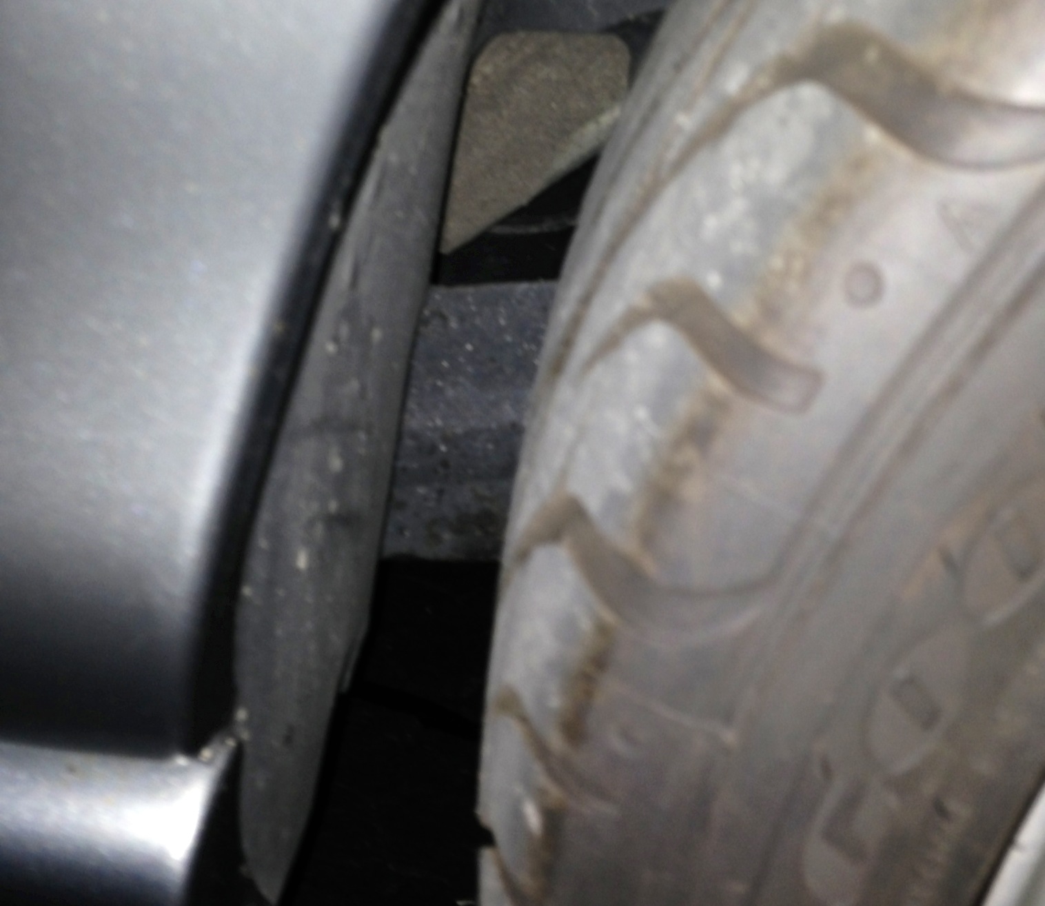

I can help! I just went through this with my X-Type. It drove me F-ing nuts for days trying to figure out what it was. I changed the caliper thinking it was that... I changed the rotor thinking it was that... i changed the break pads (twice) thinking it was that... I changed the Hub thinking it was that... After all the time and money wasted I figured it out and it's pretty damn dumb. If you look at the tire you will see a black color bar behind it and in front of it. It connects to a bolt just in front of the jack point under the rear doors. That little piece of stamped steel is bent and rubs against your tire when you turn the wheel slightly of have a lot of weight in the car. if you put your finger between the tire and that bar on one side and then the other sire of the car you will see the difference is clearance on the one side. I backed my car up on ramps, grabbed the biggest pair of channel locks i own and bent that piece back straight, and the problem was solved! I will go outside (its late and dark here) and attempt to take a picture and post it so you see what bar I am talking about. I noticed that there is a bushing or some piece of rubber that may keep the piece from turning or shifting. My best guess is that when I Jacked the car up (unrelated issue) the jack caught that bar and bent it or pushed off center.
Please look at yours and try what i said. if it works or not please let us know! Picture is on it's way!

I hope you can see the metal bar in this picture. It is the lower one that you can see in front of the tire. It is black and flat and about 3-4 inches tall. Let me know if you find it or need a better picture. good luck and I hope this helps!

thanks I see the part you're talking about but it doesn't seem to be rubbing anywhere I took the wheel off and there's no marks on the tire or the rim and seems to be decent clearance between the wheel tire and the bar you're talking about.

Hmmm. And you made sure that the bar on both sides of the car are running parallel to the tires? It took me weeks to figure out that the one bar was just a little too close to the one tire. My tire had no marks on it either and it appeared to have enough clearance. Once the full weight of the car, either by turning or driving on the highway, would cause that bar to make slight contact with the tire.
