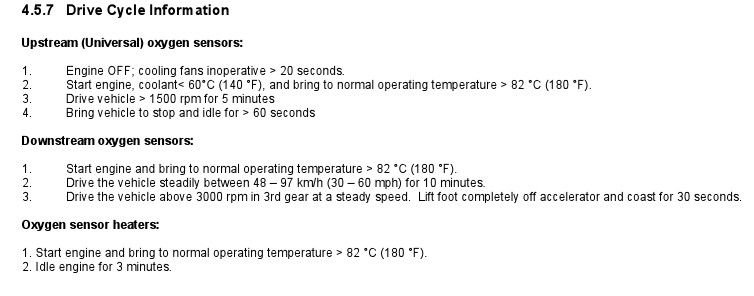

Then it must be the downstream monitor not setting. Read post #6
https://www.jaguarforums.com/forum/x...onitor-253118/
Old May 24, 2022 | 12:28 AM
Gadzooks2's Avatar
Joined: Oct 2014
Posts: 38
Likes: 5
From: Norco, CA
I must have run that exact drive cycle about 10 times.

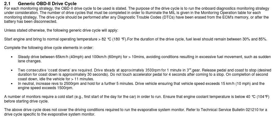

Slight quibble, you want the monitor to set (some people say reset but they mean re-set, i.e. set again).
You're doing the right kinds of things - as far as we know.
I say as far as we know because CARB rules may have resulted in Jaguar putting a different "calibration" (software variant) in your car. Maybe. If they have, I've seen no documentation specific to CA.
Jaguar certainly may have changed the software over time, whether due to CA or not, but all we have really is early doc which "escaped" one way or another.
Best I could find is the early stuff and then some later stuff for the V6 engine.
I guess (ugh!) maybe one or more O2s is a bit tired but not bad enough to flag a code, but I'd hate to start changing parts on a guess like that.

Thanks for the information. I have run those same drive cycles multiple times as well and the O2 sensor still comes up "not ready". I've even tried disconnecting the battery cables and shorting them together to start the OBDII ready cycle again and all the monitors get ready after a few drive cycles and about 30 miles of driving but O2 sensor always remains not ready. It's ridiculous to think the software identifies "Pending codes" or something that "might fail" or is "about to fail" or "someday might fail" but people call the P1000 code "pending" for some reason. The definition of "P" in front of an OBDII code is for "Powertrain" so this idea of Pending is odd. If you can drive 1,600 miles with a "pending code" the part that is "pending" failure should have actually failed by then right? Today I found this scary paragraph online ." These codes are referred to as pending or maturing codes. Pending codes are caused by intermittent faults or faults that the PCM needs to see happen in two consecutive warm-up cycles to set the code. If the fault does not reappear within 40 warm-up cycles, the code will be cleared from memory." I don't drive the car daily any longer since I'm retired and I am ready to sell it so driving it daily for no other reason and buying gas to do it is really making this a lot of effort and cost for a car with absolutely nothing wrong with it.

I have been in contact with the California ARB a few more times. After a few back and forths they reached out to Jaguar and was given a slightly different drive cycle than any other cycles I have seen. It goes like this and I will start running it tomorrow with fingers crosse that it may help. It was also suggested that my intermittent failing speedometer may have an affect on the OBDII monitor ready cycles since the computer is looking for certain MPH for specific time periods. I would be shocked if the computer was looking for feedback from an instrument rather than using the VSS and ABS sensors to determine actual MPH but just in case I had the speedometer repaired and will see if the monitor gets ready now.
Carry out a road test and perform the following operations.
1. Accelerate to 55 mph (88 km/h) in 5th gear and cruise for 2 minutes with the engine speed at or above 1800rpm.
2. Lift off the throttle and allow the vehicle to decelerate until the engine speed is less than 1000 rpm.
3. Stop the vehicle.
4. Release brake, allow the vehicle to move with no throttle for 1 minute.
5. Road test is now complete.
