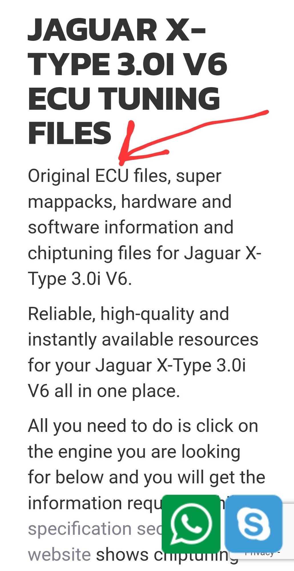

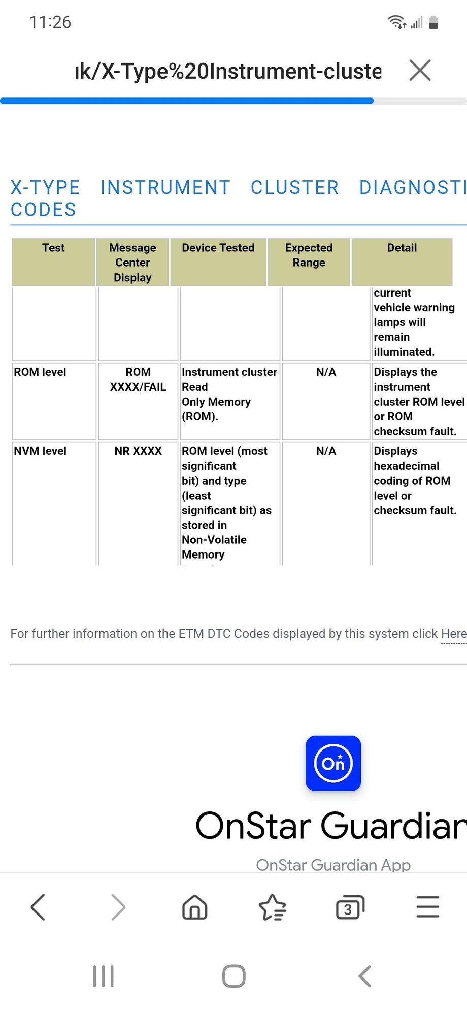

https://www.jaguarforum.com/threads/...version.66962/
https://www.ziptuning.com/ecu-tuning...-type-3-0i-v6/
