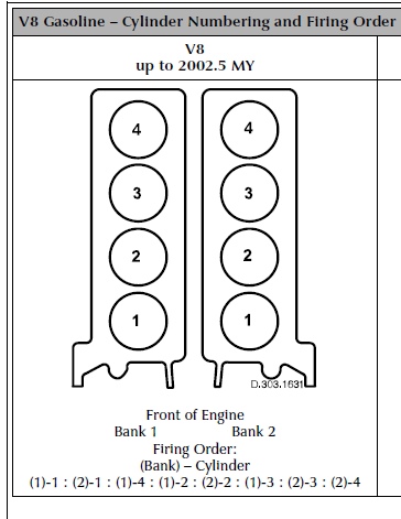

Just double checking here though. The P1647 code is bank one which should be on the right side....right?

"The right hand cylinder bank is designated as "A"
bank, and the left hand as "B" bank. The cylinder
bores of each bank are numbered from 1 to 4,
starting from the front."
Quoted from manual (above) from sitting in the driver's seat. If the only choices
you have are bank 1 and bank 2, then I guess it'd be the right side for bank 1.
Old Jul 9, 2010 | 10:46 AM
H20boy's Avatar
Posts: 11,345
Likes: 1,165
From: Oak Ridge, TN
if you're more of a visual guy...(I am)
