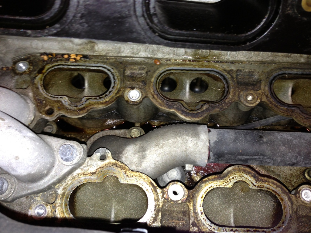

Hello fellow owners.
Recently doing the spark plug and gasket changes and boy did it need it. No check engine lights just scared me when I pulled the plugs. Had to be as old as the car lol.
Anyway. As I was pulling it all apart and cleaning it up I snapped some shots of what appears to be oil pooling or pooled. I can confirm it is currently not leaking as there is no evidence on my garage floor.
I will let the images speak. Any input is appreciated.
Hope you can see it. Wondering if this is a big deal.
Attached Thumbnails Oil pooling?-7ac4e739-660b-4544-99d5-5437da24419e-19361-00000575ba0b37b9_zps869a1102.jpg

If there are no visible leaks and you are no using a noticeable amount of oil I would guess its just from spillage when topping up? Can't really think of anywhere else it would come from there. Sorry cant help any more.

I wanna say its from the previous owner or something that the dealer fixed before I bought it possibly...my vehicle isn't leaking any oil that I can tell and when I get my oil changed they don't mention its low or no lights come on at all so I can presume its okay I suppose

Check / Replace the PCV. This valve could be bad and letting the oil blow by, which would accumulate at the gaskets in you pictures. If these gaskets - o-rings are bad, then oil froma a bad PCV would blow by these gaskets as well. I hope you're changing out all 12 of the intake manifold gaskets, if you gone this far to find the oil leak.

Yes I have already changed out all the gaskets...I just snapped the picture as I was taking it apart...the gaskets definitely needed replacement..thank you Amazon!
