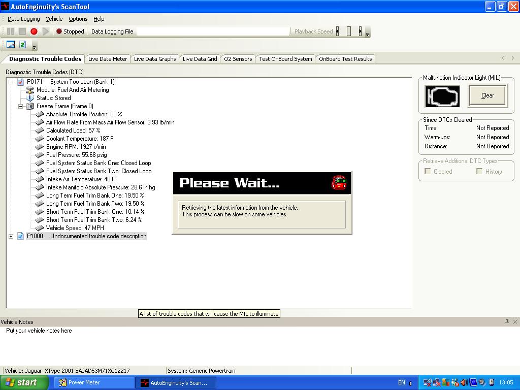

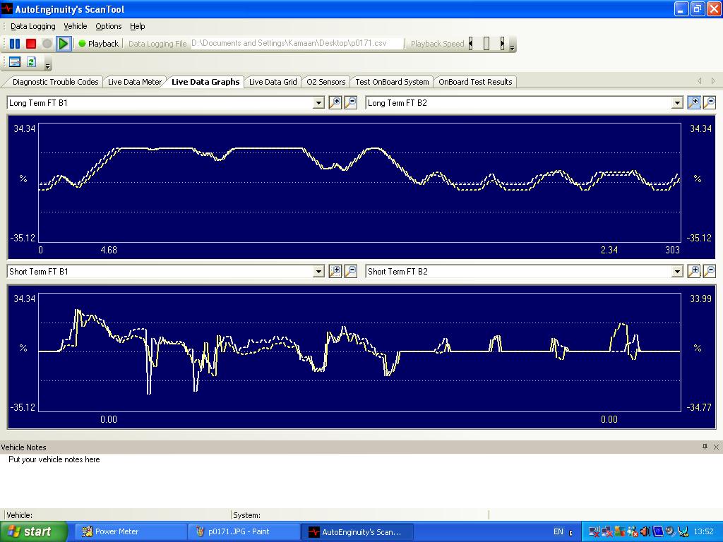

Hi,
So I still have the P0171 from a couple of months ago happening on a daily basis. It only happens under load while driving. No issues at idle or even high revs at idle so doesn't look like a vacuum leak.

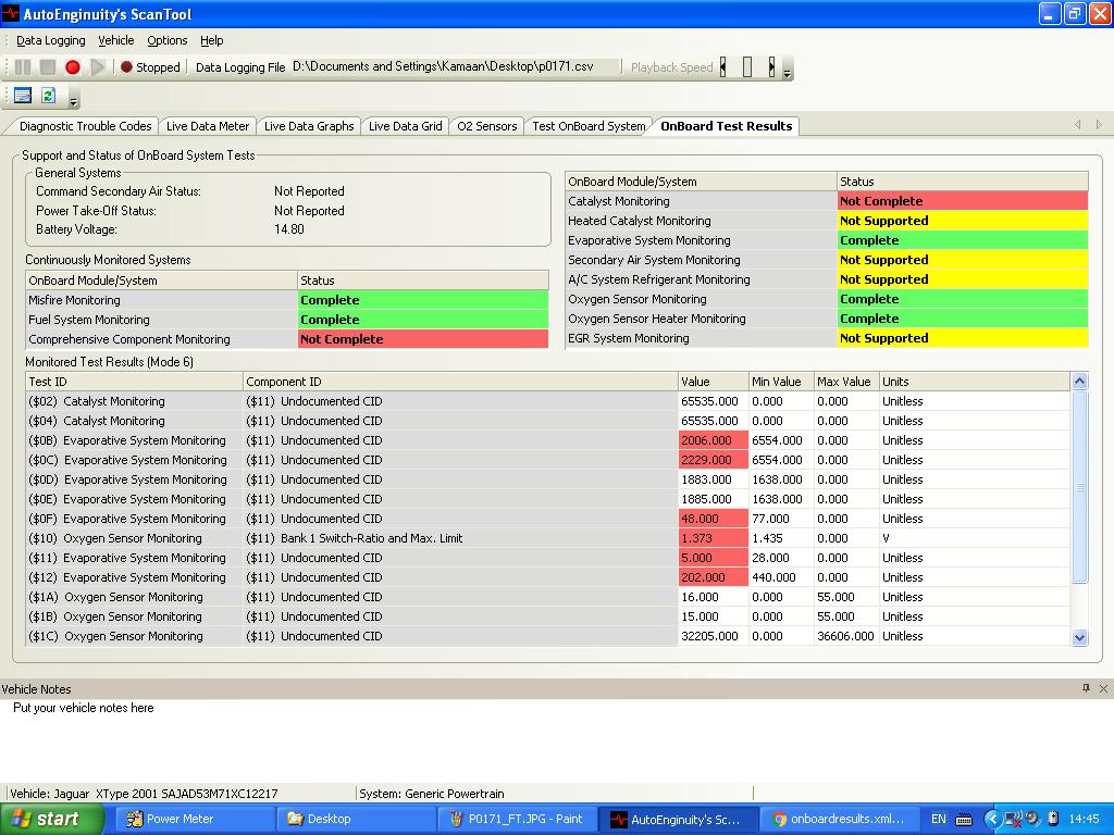

I have 3 attachments. The first shows the error code freeze frame, the second live data while driving and the third an O2 sensor check. Freeze frame points to a bank 1 issue. Live data points to both banks. O2 sensor shows the possibility of a bad sensor.
Any experienced Autoenginuity users out there who can point me in the right directions please?
Attached Thumbnails P0171 still an ongoing issue - autoenginuity output-p0171.jpg   P0171 still an ongoing issue - autoenginuity output-p0171_ft.jpg   P0171 still an ongoing issue - autoenginuity output-onboard.jpg

Both banks have high LTFT so you may as well regard it as P0174 as well.
What are LTFTs at idle, hot engine (drive it before parking, it must be hot), and again if you rev it to about 2500rpm?

Hi JagV8,
LTFTs at idle don't go over 7 even hot and at high idle (3000).
It only happens under driving conditions that I get the P0171.
Any thoughts on the O2 sensor test results? Could running the car with a misfire for a couple of weeks have damaged an O2 sensor?

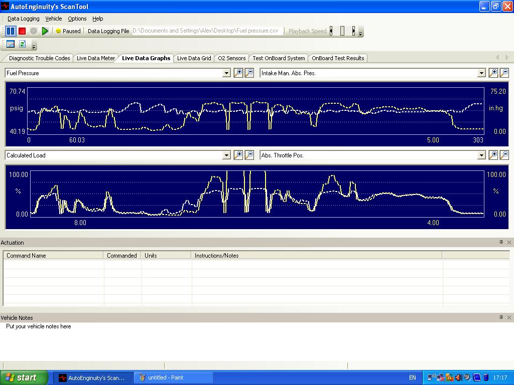

So I did a picture of what the fuel pressure, intake manifold pressure, Load and throttle position looks like under driving and accelerating (which normally leads to the high LTFT issues)
Thanks Barnter for the question. I hope you guys can diagnose a bit more from this.

In the middle there, did you blip the throttle three times? My interpretation is the fuel pressure drops at those times.

From the graph the fuel pressure is stable when I am going full throttle and releasing. The one that drops and increases is the manifold pressure.
Fuel pressure only really drops when I take my foot off the accelerator but this may be normal behaviour. I will do some research on what to expect from fuel pressure.

I would interpret the yellow line as fuel pressure. 40-55 psig seems reasonable. To me, fuel pressure fluctuates, and there's a possible discontinuity in three places.

Make sure whether it was changing gear as then it may well back off the throttle etc.
