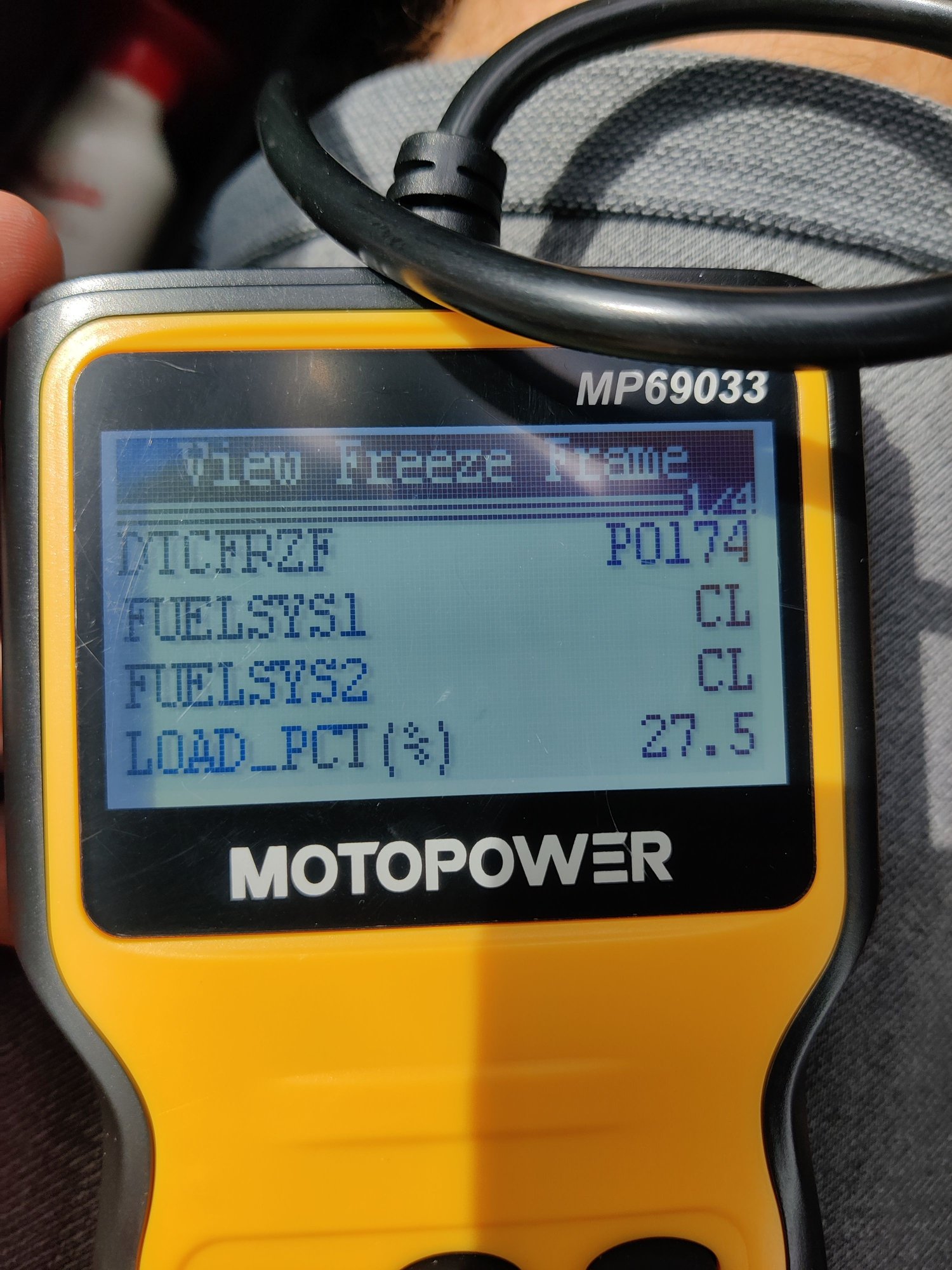

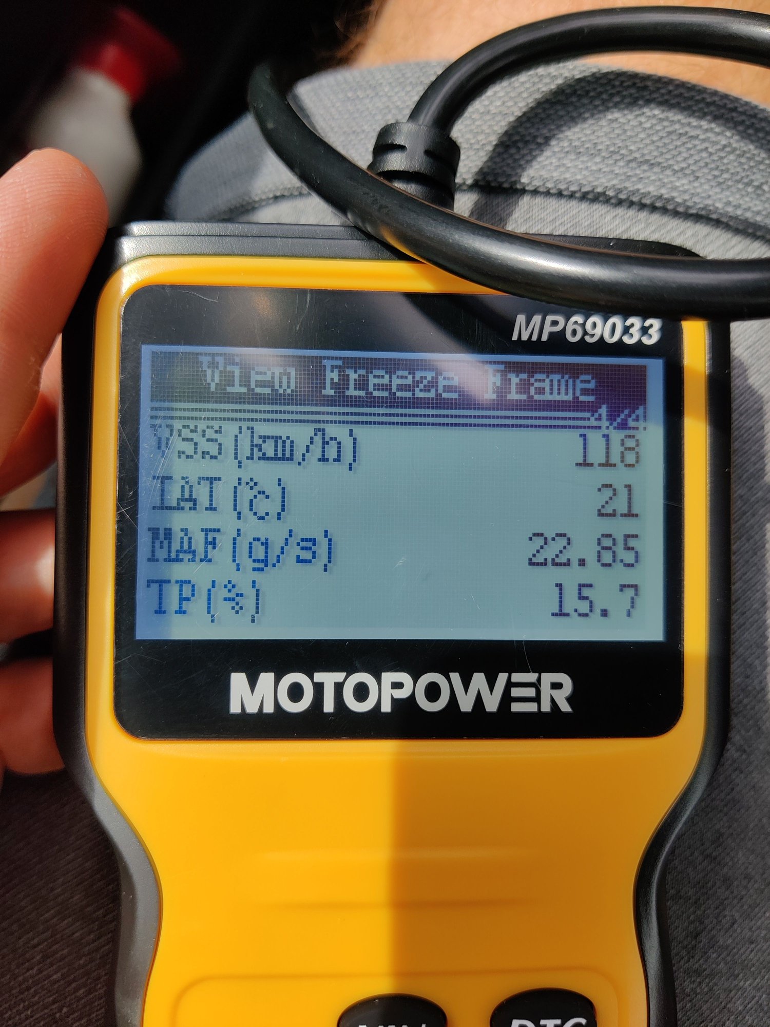

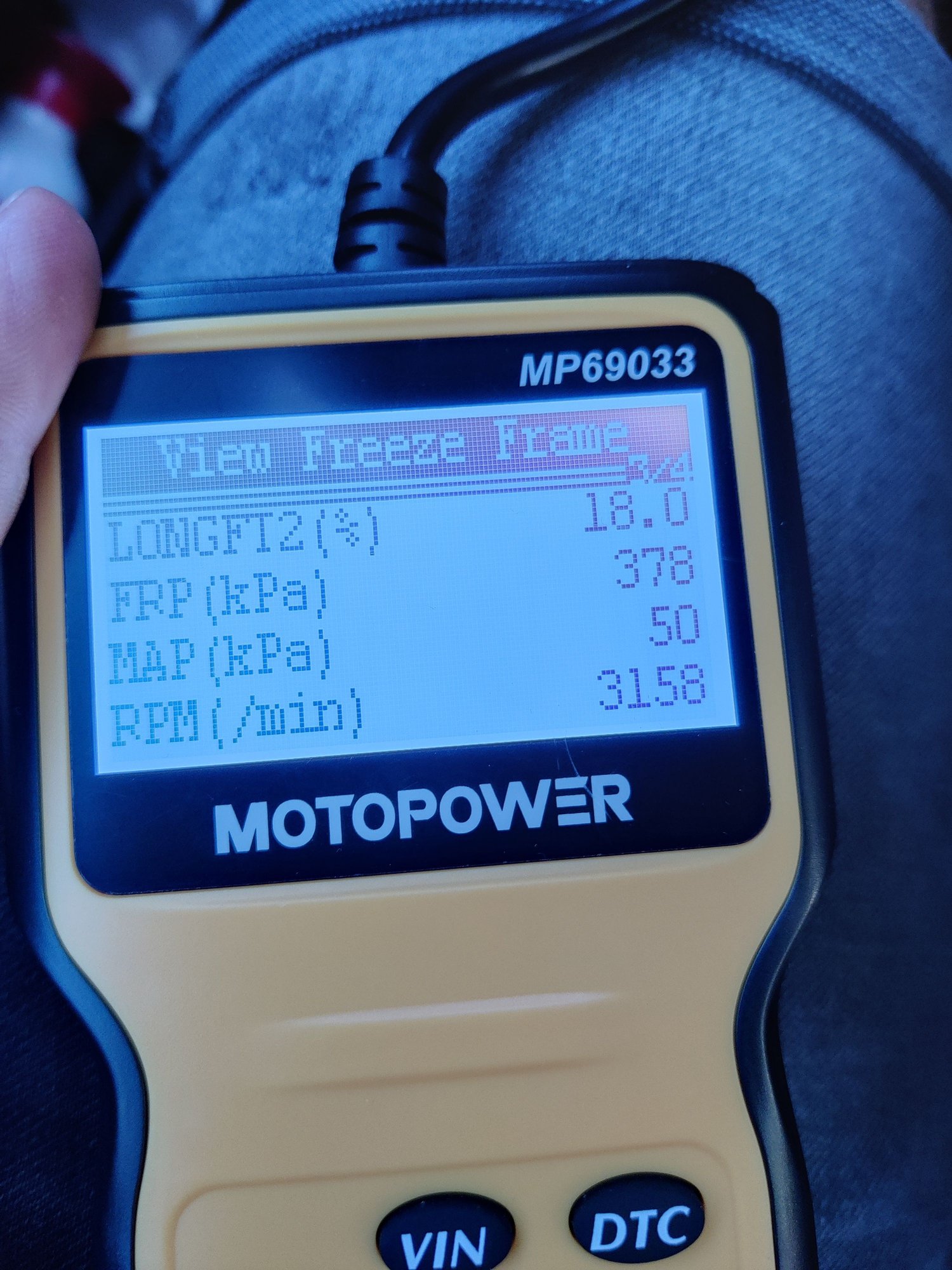

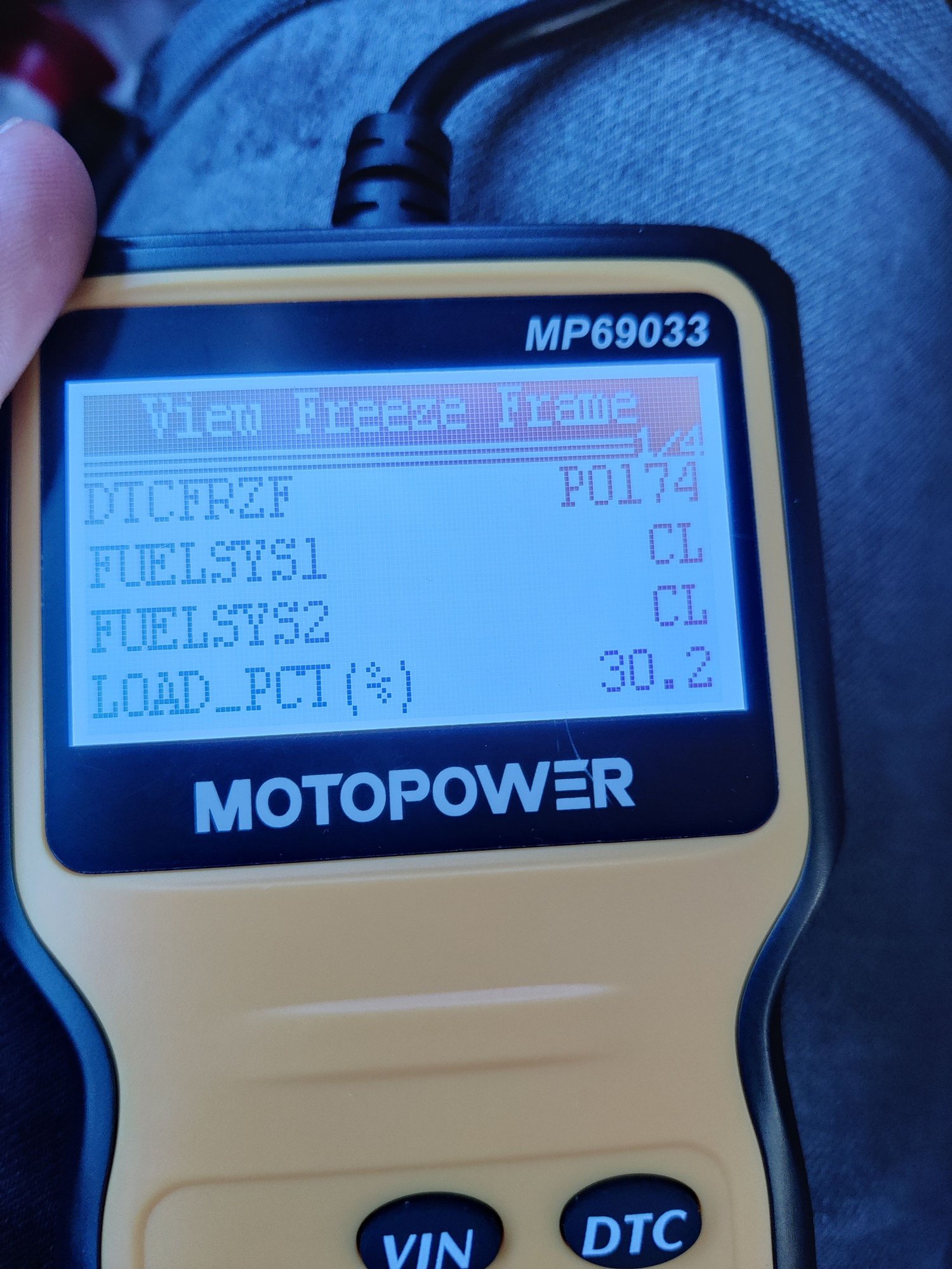

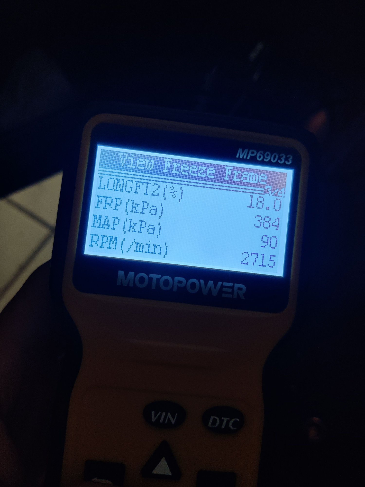

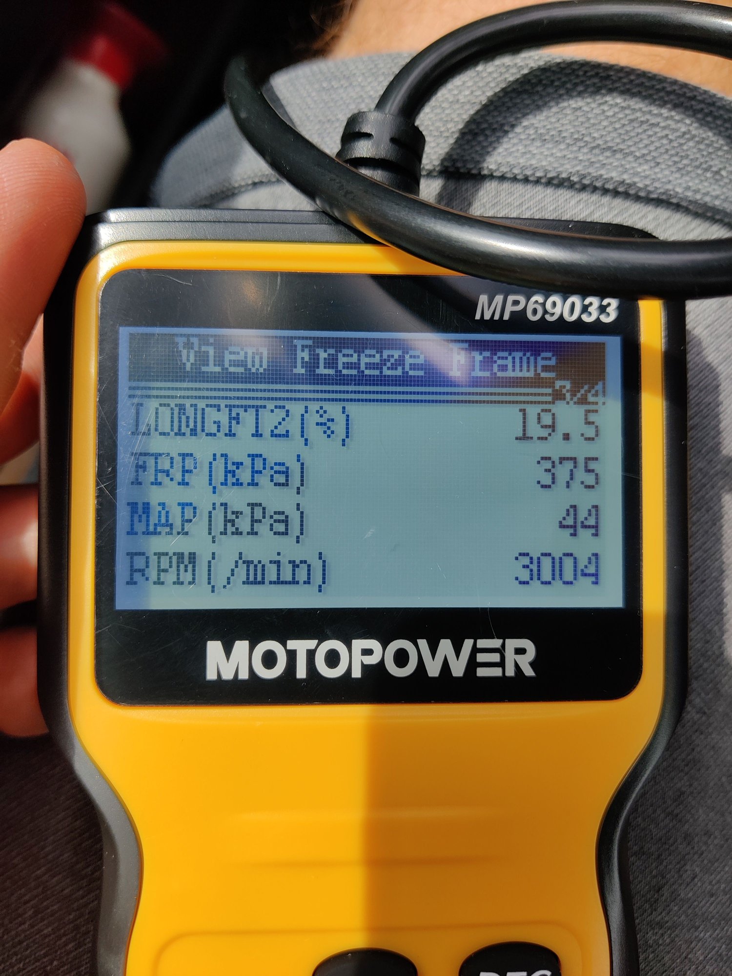

I've added some pictures of the freeze data when the fault occurs.
What are you're thoughts about this?

MarcoB, do you smoke or have a friend that smokes? If so, get a nice cigar and smoke it, but gently blow the smoke into the engine bay with a cold engine. Make sure to blow the smoke across the top of the engine. What you are looking for is the smoke to make a sudden direction change. That will point you to your vacuum leak.
Before you do the smoke test, I would tell you to check 2 more things. First being the PCV hose running next to the throttlebody. From the sounds of things, you may still have a smooth hose there (going to be about the diameter of your thumb, running to the left o fthe throttle body). First off, is this hose smooth or does it have a pattern on it? IF smooth, pull that hose and look on the back side. Odds are, you will find a long split in the hose. Replace the hose. If you have the hose and it is not split, replace it anyways because if it isn't failed now, it will fail in the near future. If you have the hose with a pattern on it, then you have the upgraded hose and that should be good, but it can leak on you. So, look for that to be a point for leakage.
The second thing you want to look at is the vacuum line running from the top of the intake over to the brake booster. When you get near the brake booster, you will see a bulge in the line (we call it a football, it is really a check valve). Take your thumb and rub that bulge/football. Do you get a little bit of black dust coming off of it? If yes, replace that line. Does there appear to be a crack in it. If yes, replace. This is a common failure item along with the IMT o-rings and the PCV hose. We commonly refer to these as the "Big 3".

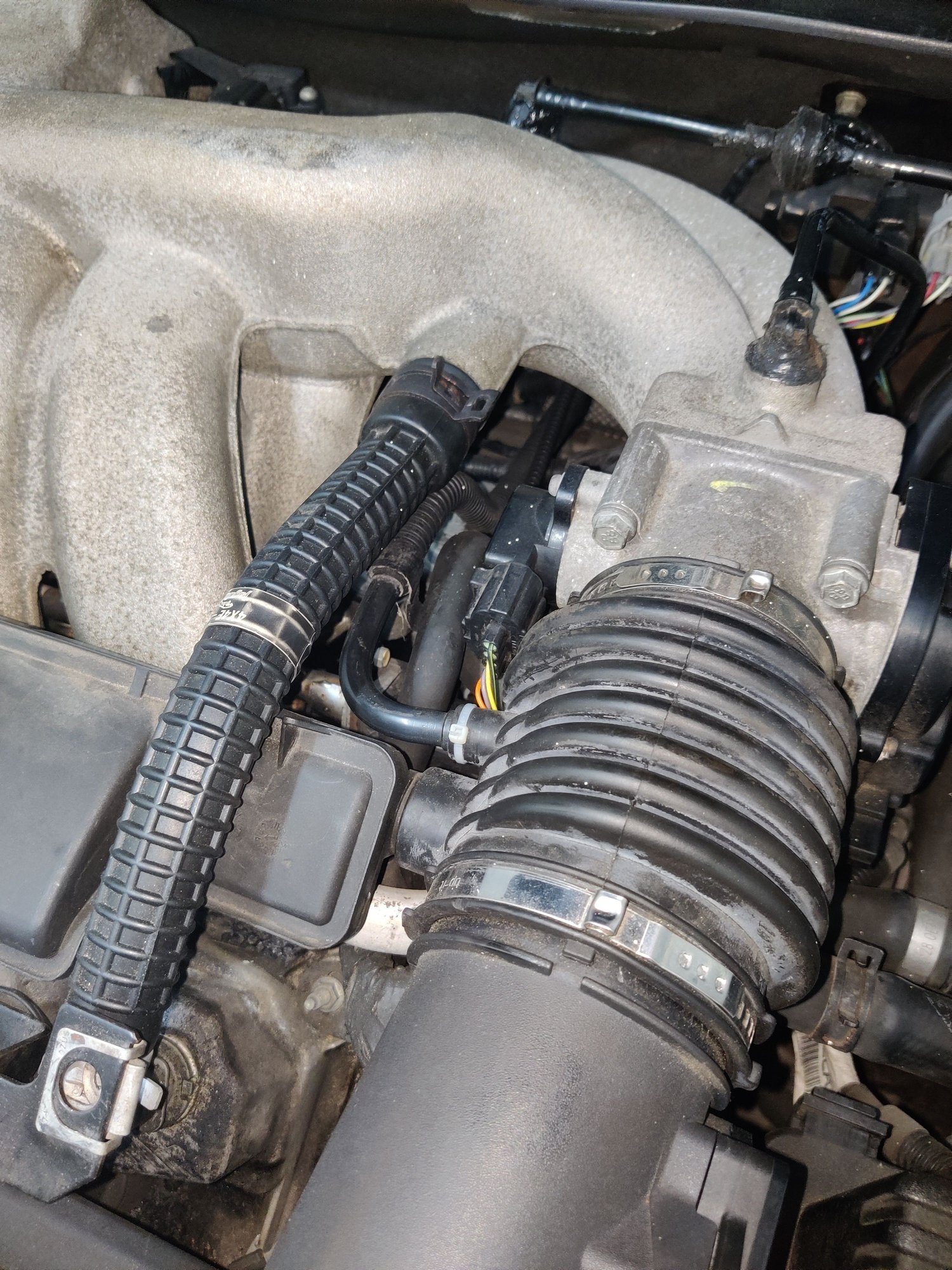

Here is a photo from the engine bay, which hose are you referring to as being the smooth one?

The chequered pattern one on the left is the one Thermo was referring to. You have the later up-rated part fitted already (patterned not smooth).
Still worth checking that for any defects, but far less likely to have failed.
The top right of your picture is the other vacuum line with the "bulge" in it that Thermo was referring to.
I see someone has previously been hunting leaks- the presence of some tell-tale goop that has been applied to the push fitting of one of the other visible vacuum line connections to the intake manifold just after the throttle body.
Also check the short large diameter air intake "accordian" pipe that couples between the solid air intake pipe (where MAF sensor resides) and the throttle body.....they can develop a split in the ribbing or the hose clamps might not have been seated or tightened correctly which can cause false MAF sensor readings.

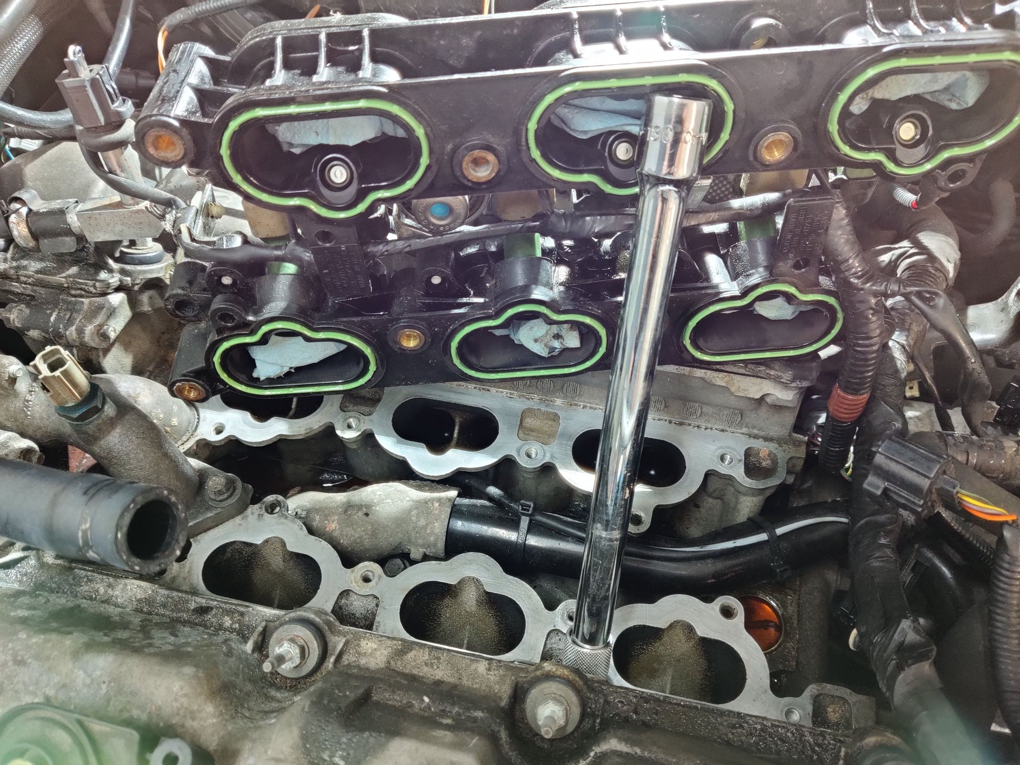

After that I've removed the upper air intake manifold, seeing that someone else had been busy hunting down this fault code, the o-rings were full of black gasket maker (color of the rings was yellow, original perhaps?) But there were no indicators of something leaking here, I was looking for maybe dry/dirty or oily spots.
After that I decided I should take out the lower part of the manifold, that was actually the easy part haha.
After I got it out I noticed a difference between bank 1 and 2. Bank 1 one completely dry on the surface, while bank 2 had a lot of oil (condensed carter fumes) laying all around the intakes, even outside of the o rings.. So my conclusion was that if a lot of oil gets out, air must come in here. Same for all 3 cilinders on this bank, all wet. The one on the right seemed the most wet of them all.
So fingers crossed today, build it all back yesterday and even replaced the bank 1 sensor 2 lambda probe because this also was giving a fault code. Gonna take it for a spin today, hope it will have done the trick!
Some photos:

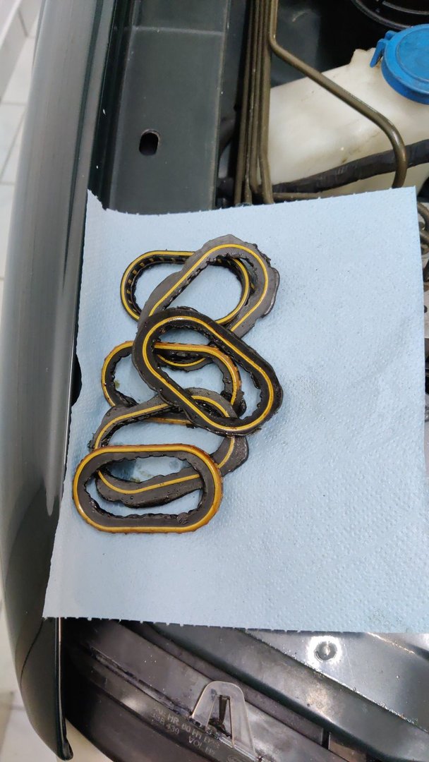

Upper air intake manifold o rings
Upper air intake o rings, with a lot of gasket maker around them xD
Lower air intake manifold o rings (new)
You'll hear back from me in a few days, if everything I did as described above works!

MarcoB, good to hear that you found the issue and now can enjoy the kitty. If you have driven 700 km and no issues, then you should be good. That is a pretty good road test.
