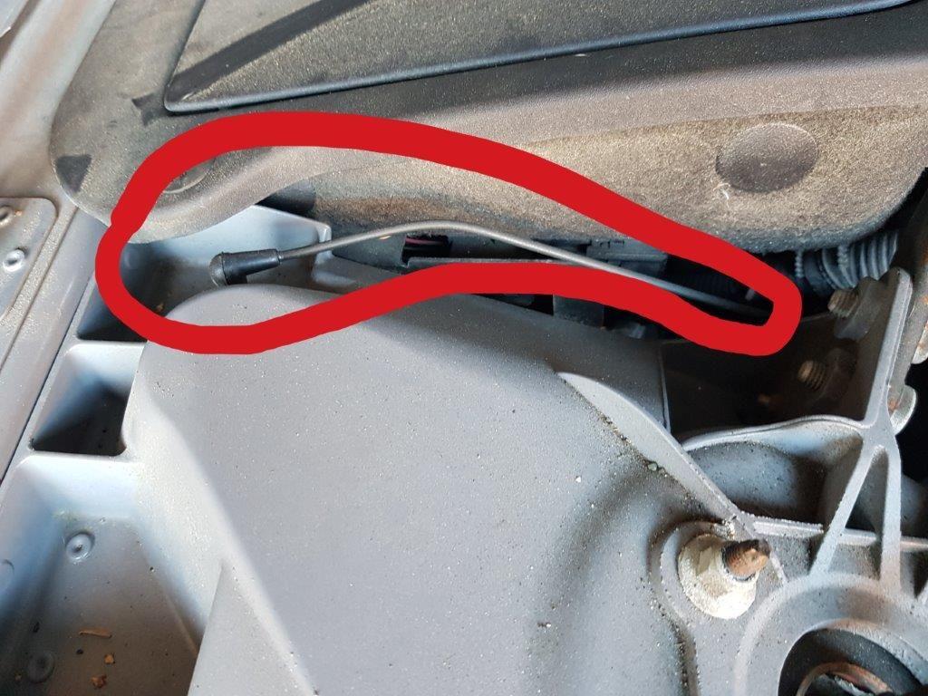

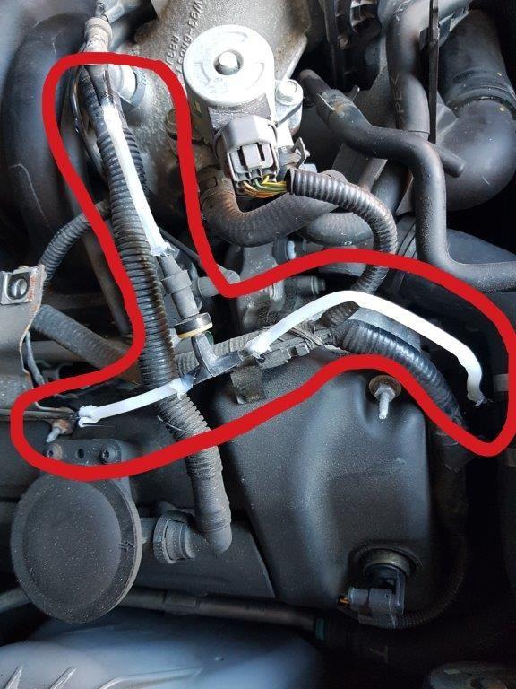

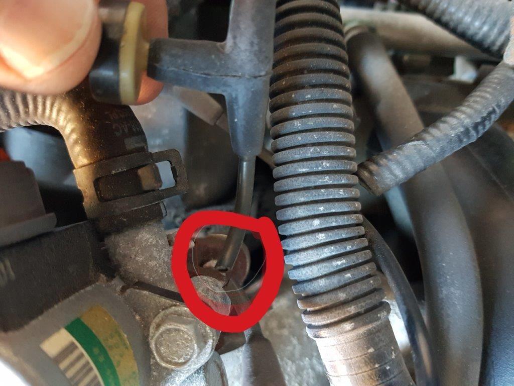

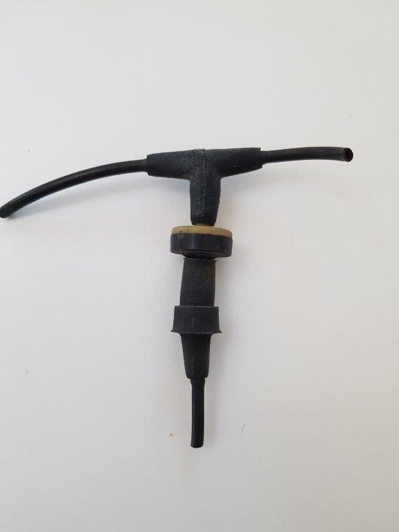

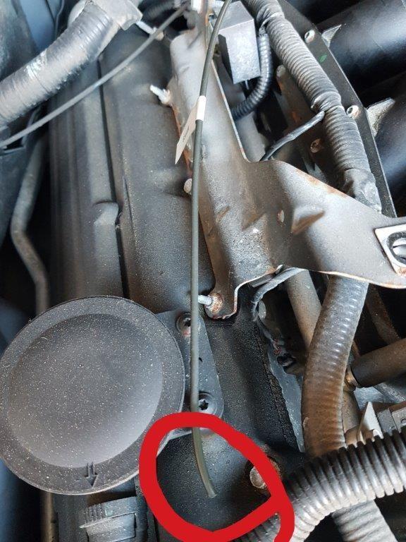

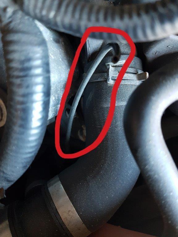

Hello all, I was cleaning the engine from dust and snapped this very thin and brittle hosing to this '3-line branched' gizmo. Would any of you know what it is and part(s) number? Is it part of the overall EVAP system?

this is the gizmo that just snapped off so easily
this is my temp patch job with silicone to seal
this leads down to the bottom of car somewhere
what is this connection for that is connected to the gizmo?
this the line from the right near-fender in the previous pic
3rd connection that connects to a valve

Valve in the vacuum hose, to the vacuum storage canister?

Looks like Secondary Air Injection System vacuum hose assy C2C22716?

Wow! you folks are fast Yep, that's the part # alright. Just ordered it now on ebay, $44.
