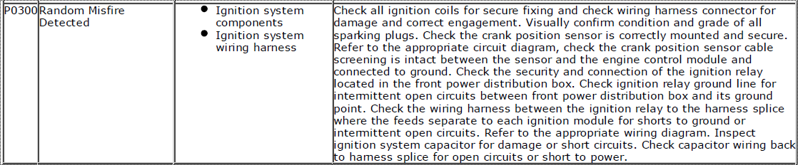

Vacuum leaks probably aren't causing the misfires, but the misfires are causing catalytic converter damage. Adding the engine type and miles to your signature will help narrow things down. See the attached png for possible causes.

p0301 (cylinder 1 misfire) p0304 (cylinder 4 misfire). You can move the coil from cylinder 4 (center front) to cylinder 2 (left front from front of car) without removing the intake manifold (required to access cylinders 1,3 & 5), clear codes and see if the error moves to cylinder 2 to check that coil.
When removing the coil, check for oil in the spark plug well. If there is oil in there then you will have to replace the valve cover gaskets. You could also pull those plugs and check their condition.
