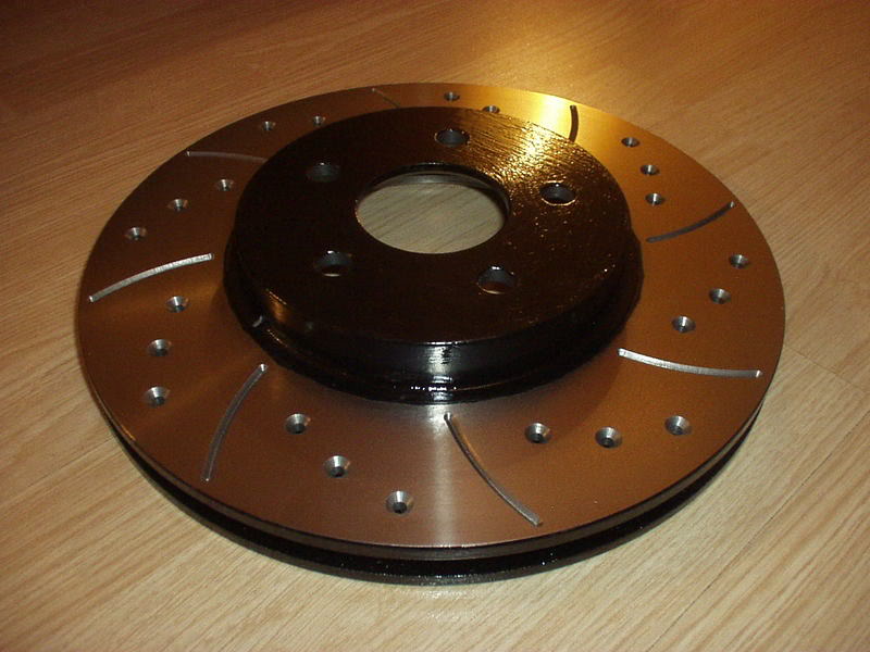

Got the grooved / drilled discs out and decided to paint them up before fitting to car.
Don't you just hate it when you get that rusty look on the outside edges and the little groove at the edge of the braking surface?
Here's the discs and the products / method used.
Firstly used masking tape to cover the braking surfaces and then used a razor blade to get a nice finish on the edge.
Then the 1st coat of Hammerite smooth black was applied to the hub and outer edges. Note: When I taped it up I left a small section on the inner side of the braking surface that will get taken off as the brakes are applied. It should give a nice smooth finish to it. On the vented discs I painted the inside of the vents too as they will start to look rusty as well otherwise.
They'll be left to dry hard o/nite and then a second coat will be applied.

More to follow as and when they get their second coat. I'ce decided on EBC Redstuff pads
DP31322C FRONT
DP31731C REAR
These should really look great against the discs when fitted.
The only question I haven't made up my mind yet ( bearing in mind the car is ST in Panther black ) whether to paint the calipers Red or black?
I'm leaning towards Red....Please let me have your thoughts on this one?

K, here's the discs / rotors all painted n cleaned up ready to go
Just waiting for the Redstuff pads to be delivered now ( Tuesday I think it should be ) and I'll be good to go.
I'm quite pleased with the results and think that they'll look good on the car

Good job Jim..I don't know what kind of paint you used..but that will keep them looking clean and sharp, for many miles to come..

Thanks Dennis....just used Hammerite smooth black for them. It really is a good product and many people use it for this purpose.
The calipers though will be getting the red brake caliper paint bought specially for them...hopefully sometime soon, but the weather is terrible here right now[&:]
