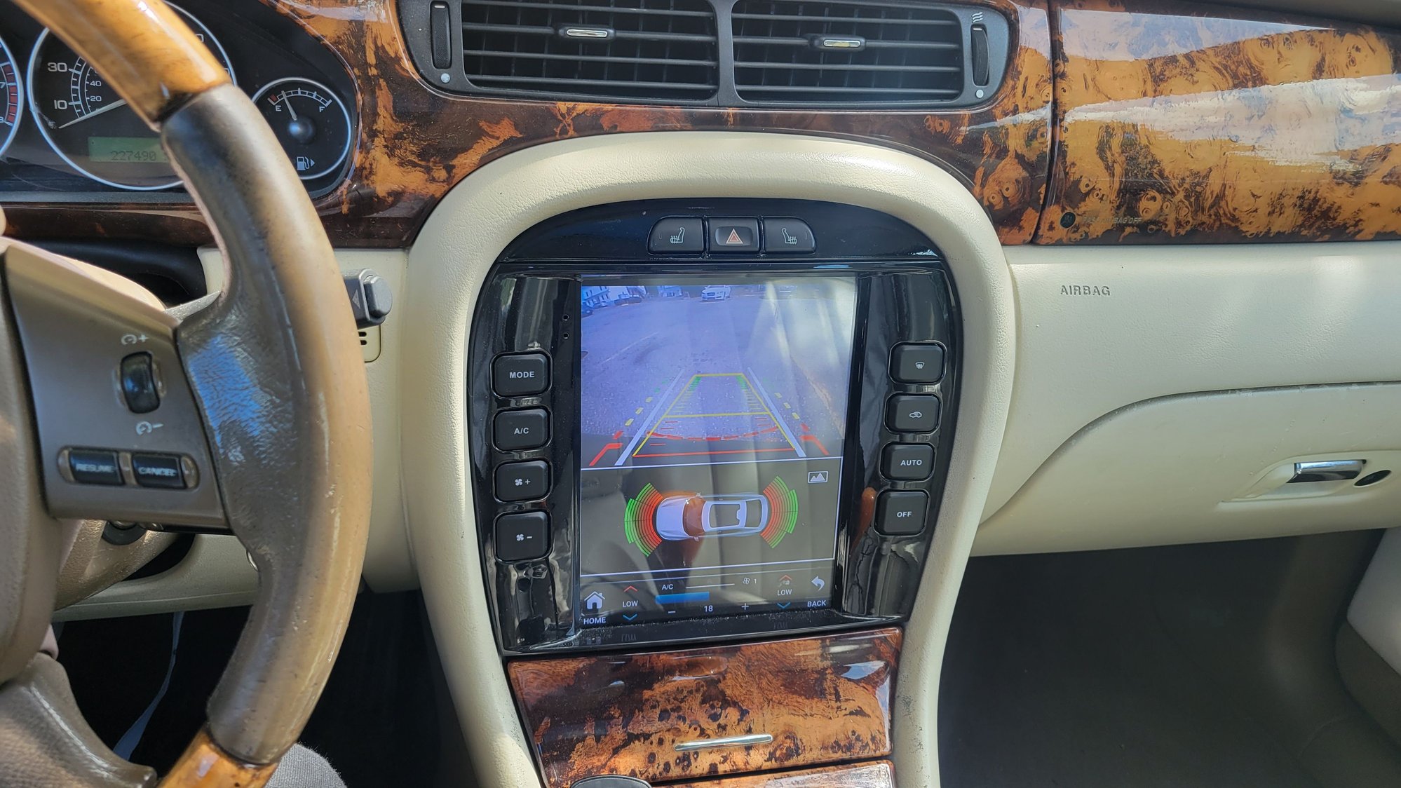

JBL-DSP AMPLIFIER
BACKUP CAMERA

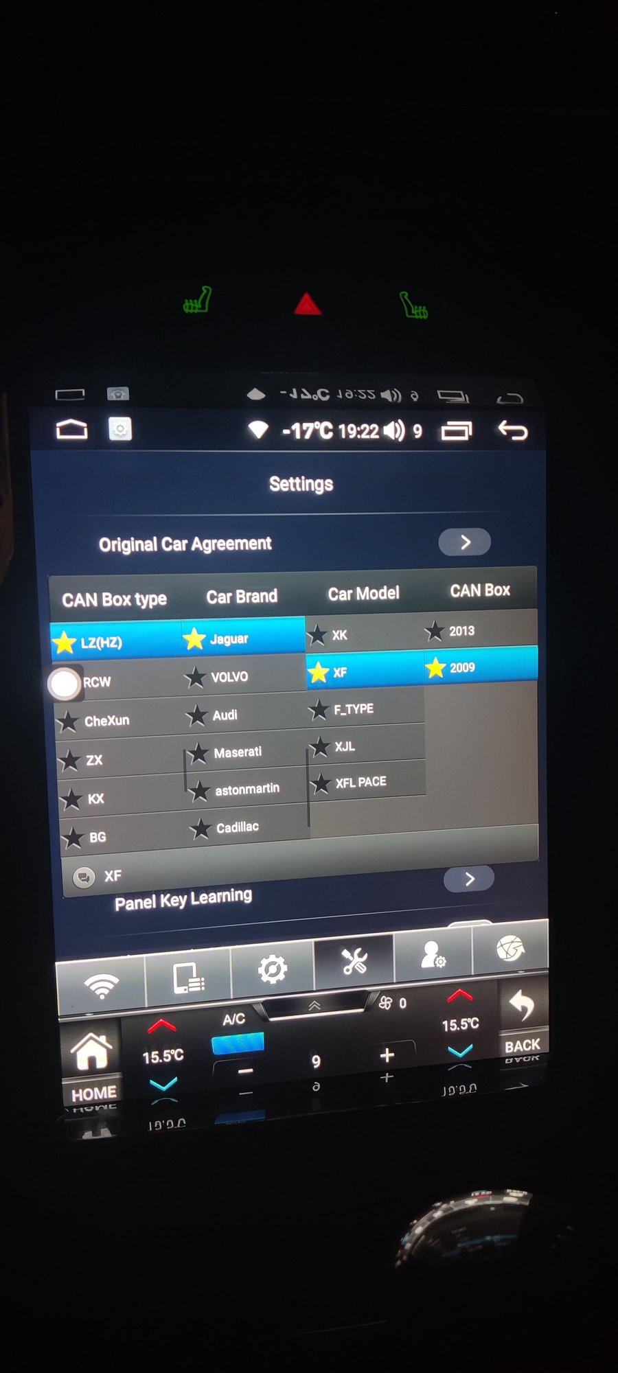

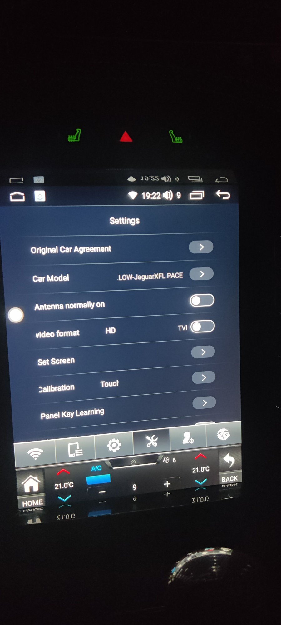

Good news. Hope it will be helpful in my situation. Yesterdays pals installed the device into the car, but climat control started living its own life(. It seems that the problem lies in the settings menu, because there is no my car model there (jaguar x-type). Any other models I’ve tried do not work properly. The way home from garage was full of new eperience, -17 C outside with side windows were ice covered ).

where did you purchase your unit from ,and did you have the stock nav or non nav

Our maniac state is under financial restrictions thus we can make internet purchase only in several countries. My device was bought here https://aliexpress.ru/item/100500465...158.1653757604

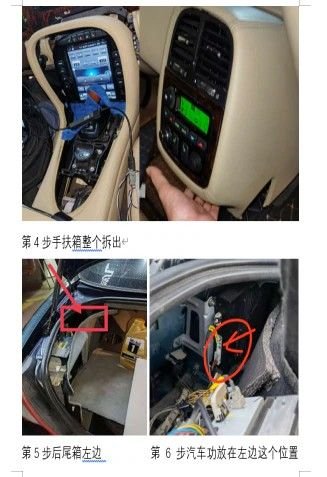

There was no insruction manual, When i asked the seller to send me one, they gave me only couple of lower-quality pics of cable connections in XJ trank.
I have the stock nav without extra amplifier.
