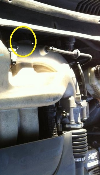

Hey guys,
First off thanks for all the information on here. I've been able to change the spark plugs and put new seals on the manifold and valve covers. When I was pulling the intake manifold, I noticed the boot pictured was torn and the line going in was taped (poorly too). I need to replace the rubber boot but don't know the part number. It's the line coming from the back of the intake manifold facing the firewall. It's the only one back there. It's in between the two bolts that you loosen when removing the intake. Does anyone know the part number and if it's the boot only or the whole line set up? Sorry for the bad pic but I stole it from another guy on the forum as I'm oversea's right now.
Thanks for any help.

if that's just the little vacuum plug back there, I would take it into a parts store and see if they have a universal connector that would fit on there. I have also looked for the name of that part and haven't been able to find it...

Guys,
It's a whole piece that has two vacuum plugs and a hose on it. You can't just purchase the vacuum plugs. The Jaguar part number is 02C2S28870 labeled as "hose - vacuum". Cost is around $30.00. Hope that helps.
