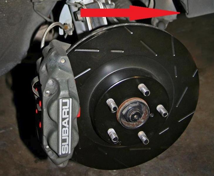

The theory with slotted discs is they remove dust, dirt and water as they rotate, To do this the slot needs to be rotating from centre to perimeter. Fitting is therefore in this orientation where the red arrow is direction of rotation:
Apologies for using a Subaru pic. I couldn't find a Jaguar one which shows up as clearly.
