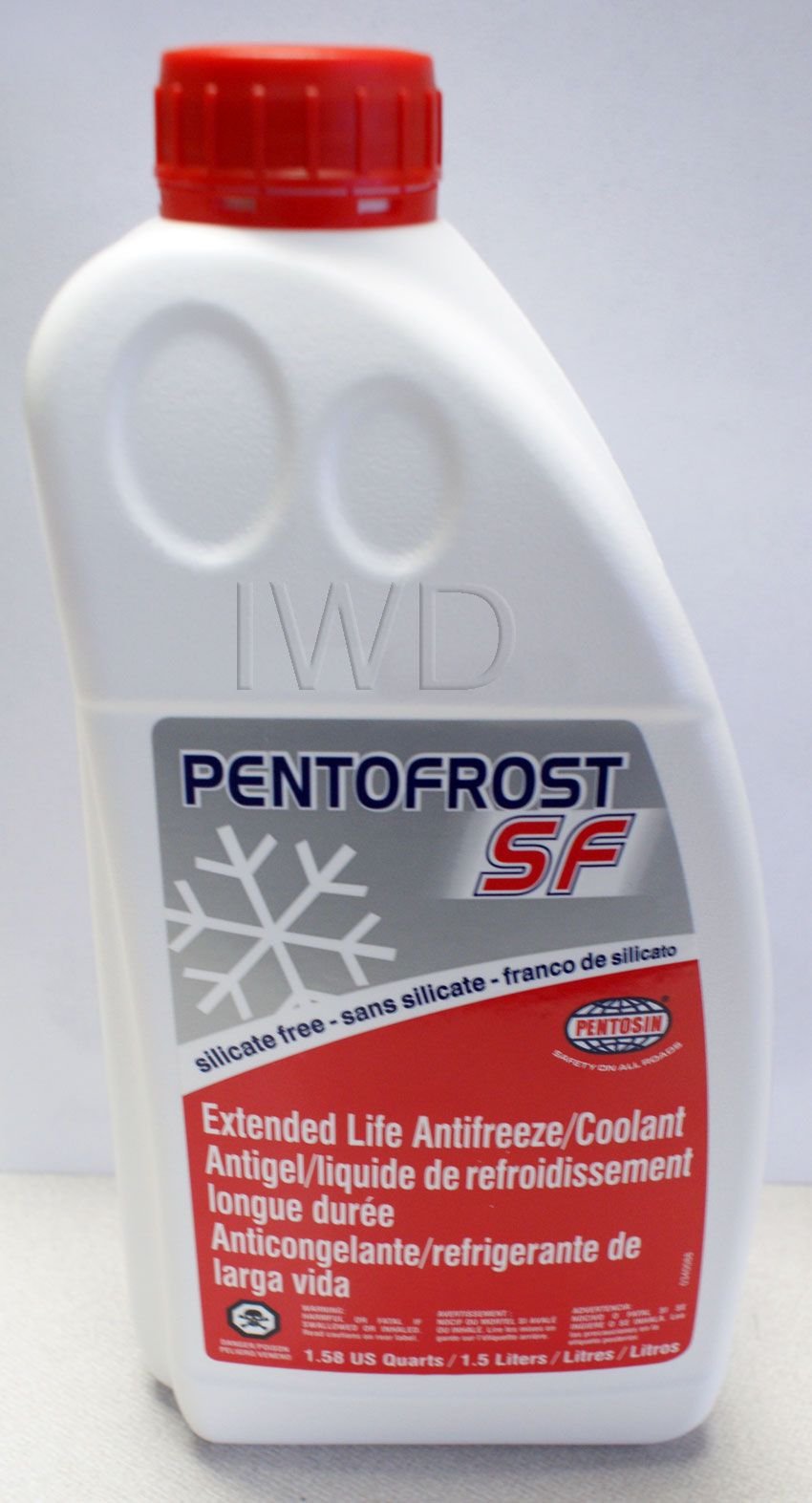

You guys tried this stuff?
I'm about to replace hoses and the water pump, and the car has what appear to be a reddish coolant in it now. I'd like to just drain and fill, and hopefully this Pentofrost can be mixed with whatever reddish (OEM?) coolant is in there.

Does it meet the required Jag spec listed in your owners manual?

"SF" meets the specs, "NF" does not.

I know it's the right coolant for the car, and supposedly good, but I was actually mostly curious if it could be mixed with factory coolant without gelling. I probably should have just asked that.
I've heard that factory coolant is pink, which turns darker, becoming reddish when it's "wearing" out. Mine looks like that. I've also read that the factory coolant is orange. This Pentosin is pink.
I may have an intermittent radiator leak, but I want to replace all the hoses and water pump first, then keep an eye on the radiator. So, for now, I don't want to do a full flush, when I may also be replacing the radiator too, soon.

Coolant colour is no longer a reliable indicator of intermixability as it once was.
The OEM specification is the sole method of making a decision.
