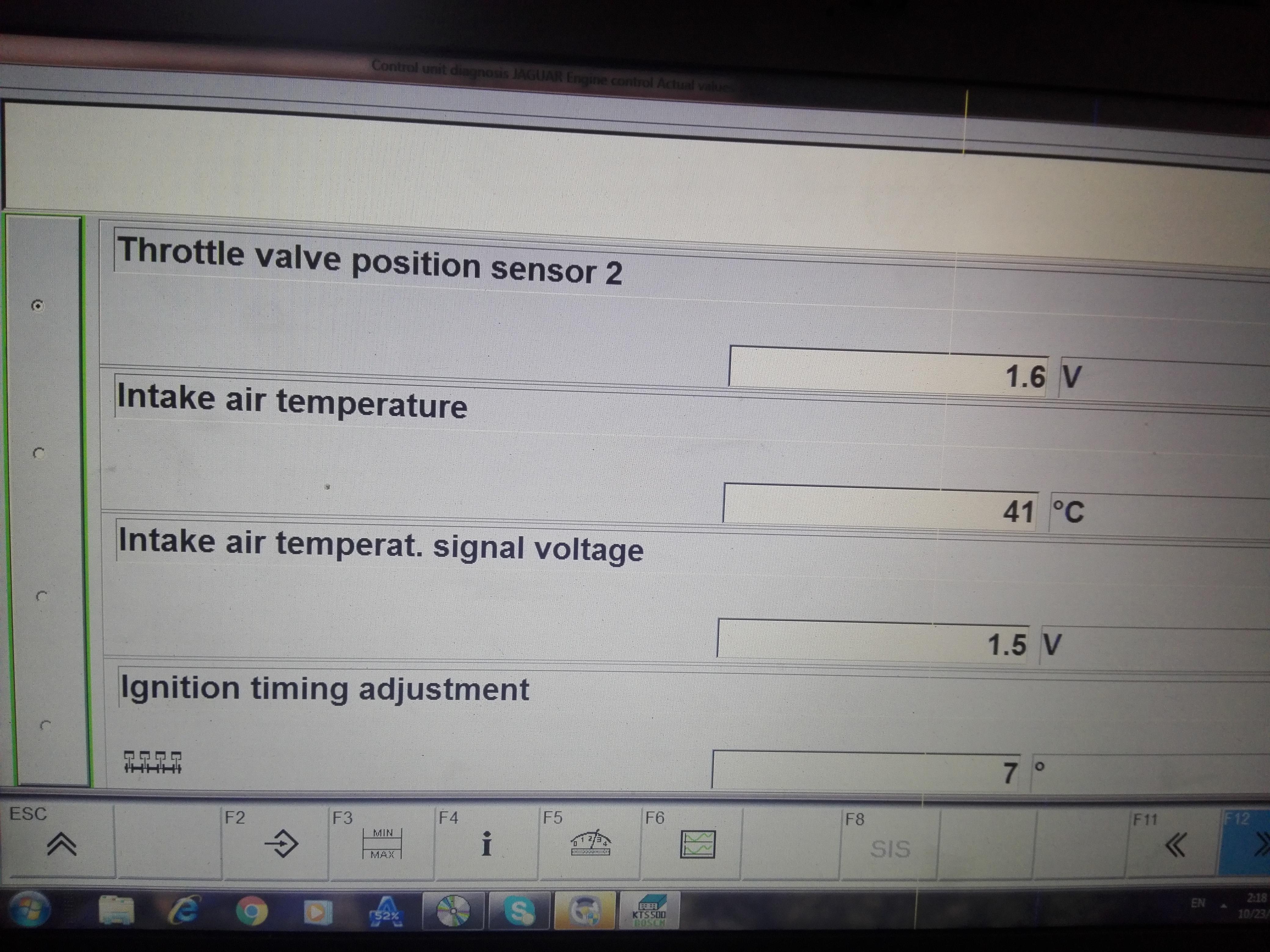

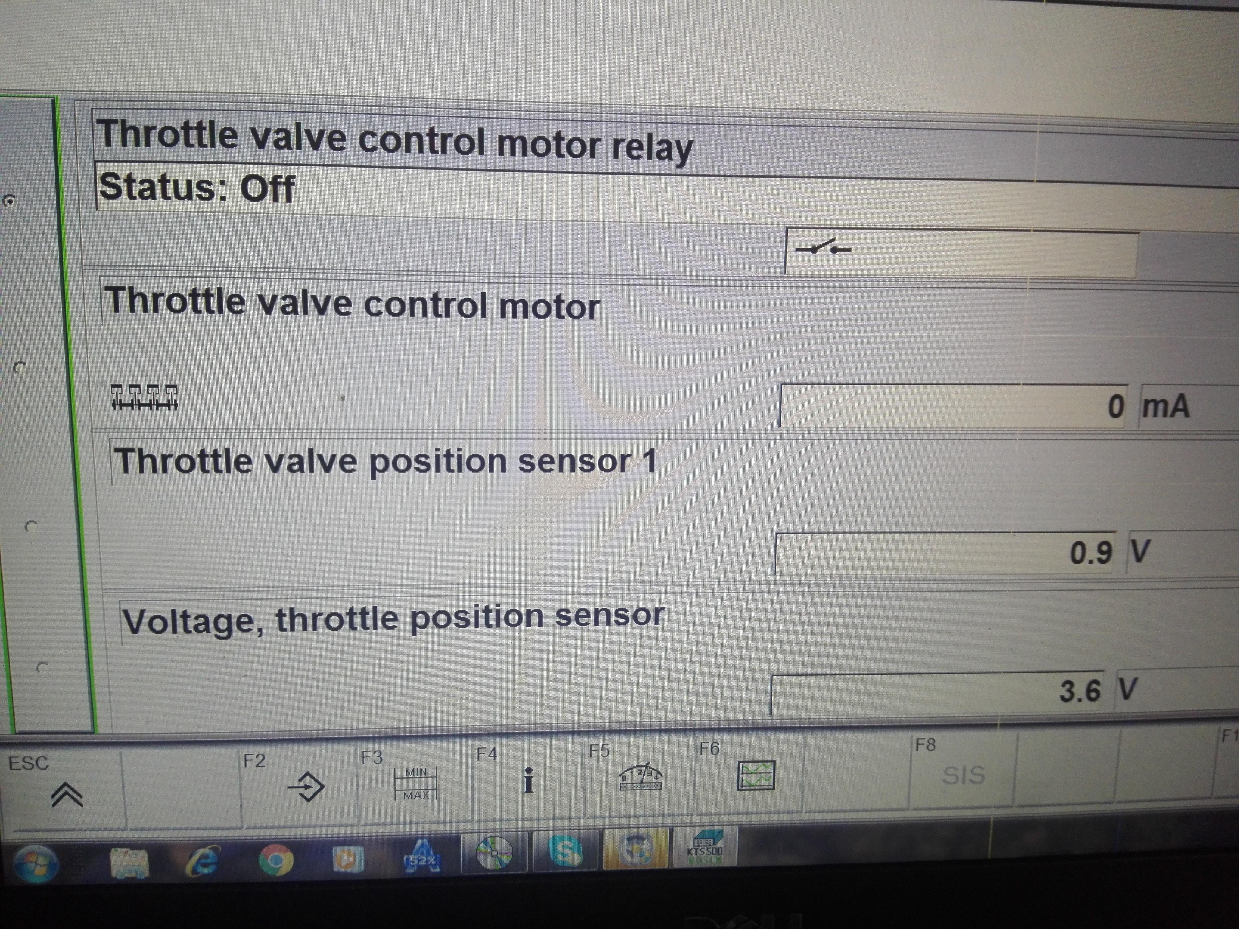

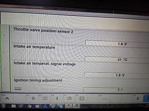

Old Oct 23, 2017 | 05:28 AM
Alex Jghamadze's Avatar
Joined: Oct 2017
Posts: 5
From: Rustavi
Default S.A.
Hello
​​​​​now I start a car and check actual values.
car not take after 3000 rpm
best regards

Old Oct 23, 2017 | 06:00 AM
Joined: Oct 2017
Posts: 5
From: Rustavi
Thorttlw valve control monitor is turned off and 3000 rpm max. Gearbox fault in Manual transmission why ???help me please.. why turned on thorttle valve control monitor...
Old Oct 23, 2017 | 06:47 PM
Thermo's Avatar
Veteran: Navy
Joined: May 2008
Posts: 14,803
Likes: 4,102
From: Great Mills, MD
Alex, I would say to get your hands on a copy of the Jaguar Work Shop manual for your car (should be available for download under the sticky at the top of the main page under X-Type). If you go to section 303-14A, there is a troubleshooting section under there. Go to "Pinpoint Test T" (page 1306 of 2810). This will give you a step by step of what you need to do to isolate it down to a specific problem.
Before you go too far into this, did you try the relay swap like I mentioned? that may be a quick fix for you.
