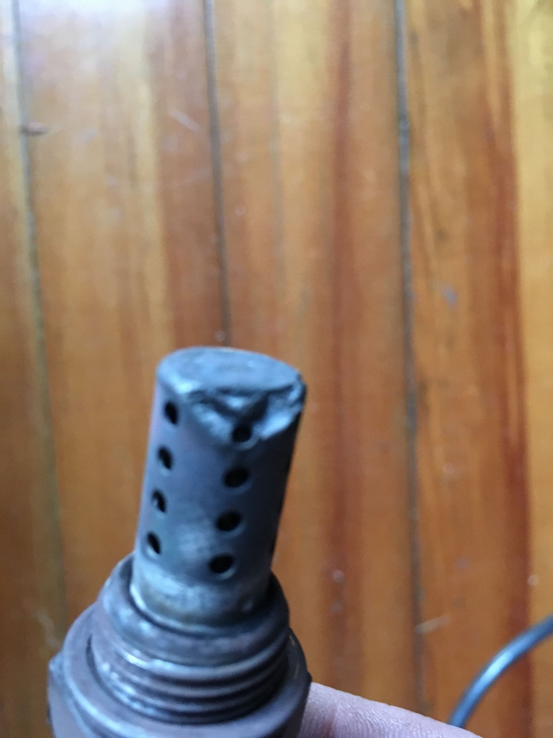

a 420 is already set as a pending code so decided to go ahead and install the mini cat and new 02 in the downstream bung as im already overdue for inspection (mot).
i'll update in a couple of days
tip of the downstream 02 sensor is pretty beat up
