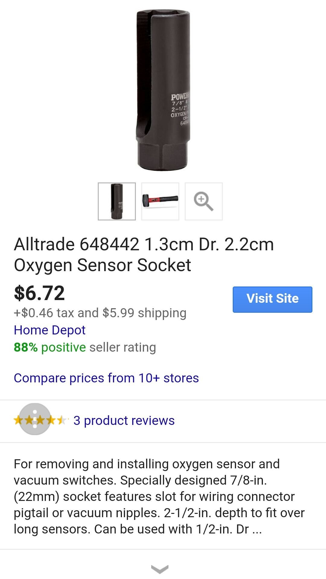

Idk of one without cutting the wires, then using a SIX point socket. In reading most people with problems getting them out use pb blaster first (not WD 40 = flammable), let it sit then heat the surrounding area with a torch to help expand the hole where the plug goes in.

Home depot one =

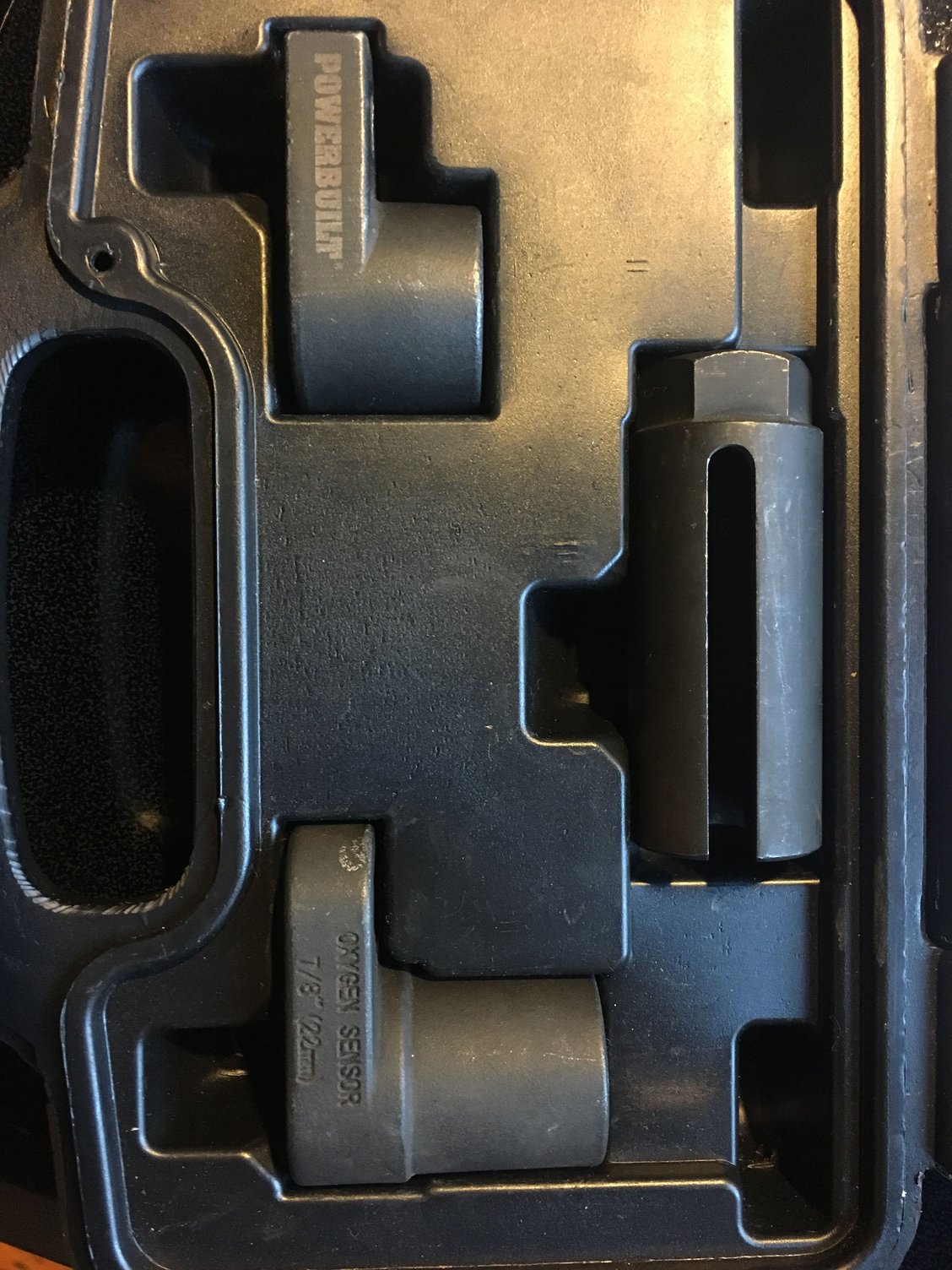

anywaysssss....i went to advance and they had the 3 piece kit in their loaner tools, so i picked that up and we'll resume play tomorrow.

i just tried the sensor i removed from the parts car in 2 of the sockets and they are both a tighter fit.
the 3rd socket is the same as mine which is also a 1/2" drive (which i d prefer for the others but this looks good ;@)

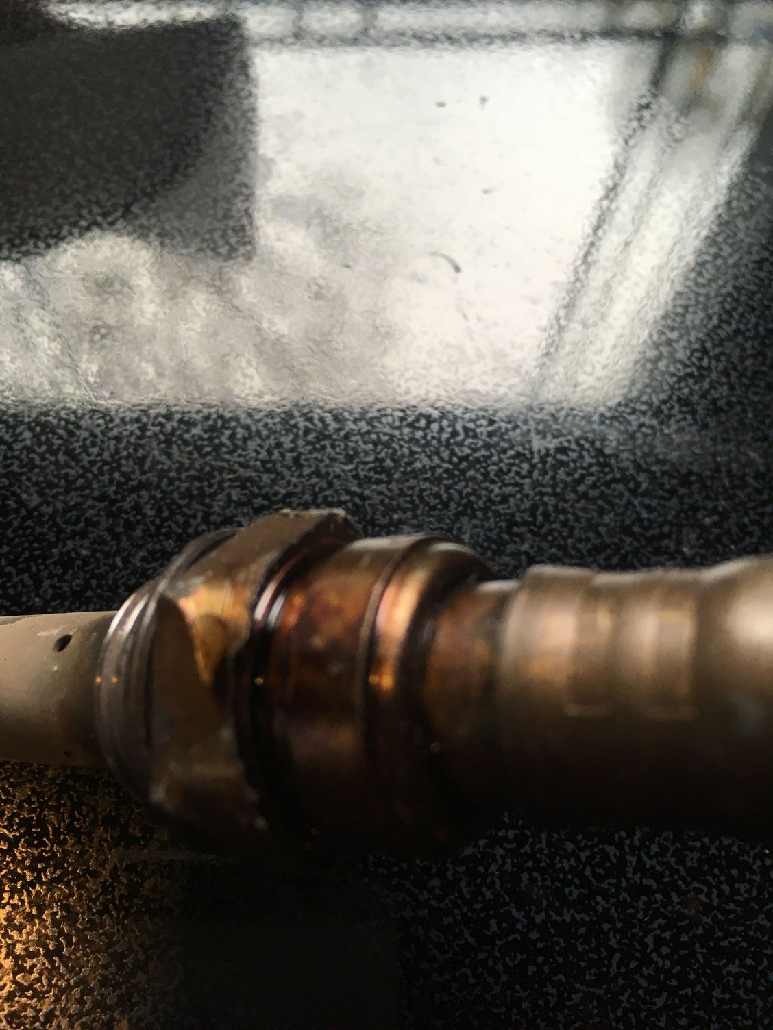

(more?) overnight soaking and using the tightest fitting of the 4 oxy sensor sockets broke the 02 sensor free.
used a 1/2" adaptor on the socket with a 1/2" ratchet. it came out hard but i did not need an extra leverage pipe.
pic shows the damage done by the first socket.
