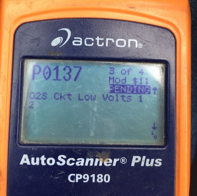

i had this as a pending code earlier after all monitors passed and before the check engine light.

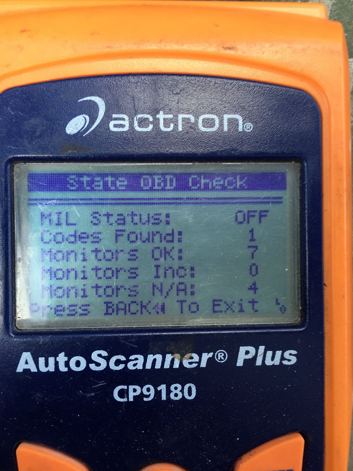

so is this odd?
all monitors passed
no check engine light but the P2a01 is still logged as a code but not tripping the CEL?
so i imagine it "should" pass an inspection/mot ???

I think that's all State specific. Here I had one pop up as I drove into the check station (had OBD going). Didn't set off the MIL & it passed. I even told JP (the owner) it has thrown the code as I entered his lot. He said no MIL and 1 here passes.
