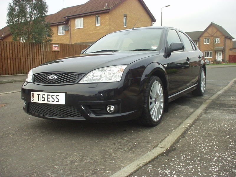

Its already a fairly quick car in 2.2 153bhp form, but rest assured a remap will make it into more of a monster. I had the Mondeo ST Tdci in 2.2 ( same engine with 155bhp ) and remapped to 195 bhp and it was electric, absolutely electric for a diesel and yet mpg was still in the mid 40's and up to 50+ on a long easy run.
