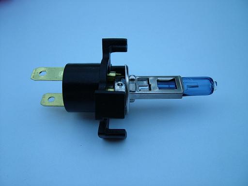

Has anyone used this to cure the problem? Will it work?
Can I still do the HID upgrade with this?

Had the same thing happen to both sided of by 04 headlamp low beams. Ordered the 4300 hid kit and am now searching for the wiring diagram someone posted one this site of the solution of having two ground wires, one to bulb and one to back of headlamp and then yellow wire to bulb as positive lead. Does this bypass need to be done when you replace with HID lamps ? thanks ch
