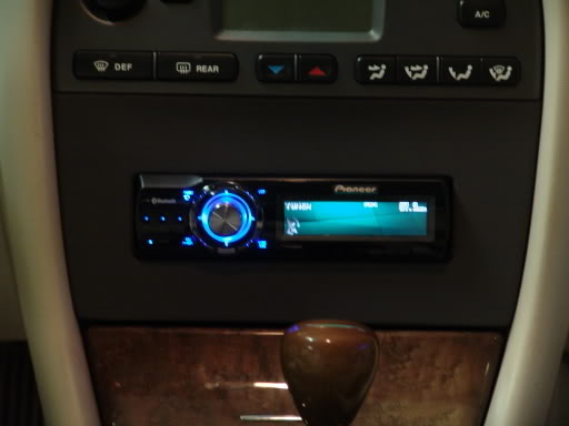

true. I seen some guys x-type on cardomain and he had the sweetest car kit, it looked stock. I asked him where he got it and the BA#$@RD didn't want to tell me. I will try to find the pick to show what I mean.

This is it, I think it looks realy good.

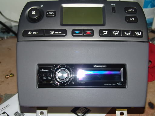

Hey wangan don't worry about it...are you familiar with mdf at all? There have been many that have made a dash kit. The hardest part is matching up the color of the climate control plastic to the face of the dash kit. Here's a link to a a how to a guy did. To get a wiring harness for the radio bigdreams used a ford harness on his s-type and I'd find it hard to imagine that they'd use a different one on the x-type. You'd be looking at $20 bucks worth of materials and another 7 bucks for the harness from your local walmart!

ORIGINAL: wanganracerx
I've been staring at that picture for a day now wondering why it looks so weird..... finally I got it...... I've never seen manual climate controls.

Yeah that helps. I like that kit for sure! I will try to make one rather than order one. Thanks guys!

I assume you noticed that the link in my second to last post? If not it shows how to do that dash piece. Good luck!
Yeah one I was looking at that too but I noticed right away how weird it looks w/out digital climate controls.k I kind of like the look but I think I prefer our digital ones...
