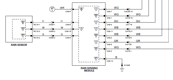

Hi, I hope you all are doing well. I'm having two issues currently. the 1st is that my wipers are no longer activating with rain. Everything else is functioning properly, so I assume that is going to be an issue with the sensor. Does anyone have any experience with this? The 2nd problem is my high beams won't shut off, however I did find some great trouble shooting advice that I'm going to start with tomorrow. (Thanks Thermo!) Any advice on the wipers will be greatly appreciated.

If all other functions are OK, might be somewhere here...
