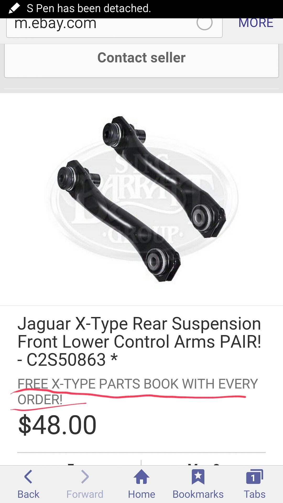

I bought these and have been very satisfied. Just be sure to read how to torque these correctly (sitting on ground, not in air).

It was SNG barrett a sponsor here, just on e-bay.
