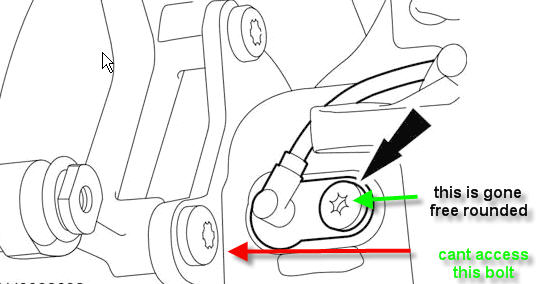

I am trying to change the rear brake rotors to the drilled and Slotted ones but I ran into this issue
while trying to remove the brake anchor plate one needs to remove the ABS bolt ( so you can get to the lower screw)
now while trying to ABS wheel speed sensor retaining bolt
it became free now I am unable open this bolt and so I am stuck..
any advice how I may proceed ?
and thanks ..
PS I have tried one size bigger but it won't work

TGK,
I am unable to access the lower bolt of the mounting clamp the abs bolts comes in between remove rear brake rotor-absbolt.jpg..

Originally Posted by bbjack
TGK,
I am unable to access the lower bolt of the mounting clamp the abs bolts comes in between Attachment 3063..
Got ya. I'm guessing yours is a later set up. Mine has bolts there not those crappy ford torques screws. You simply can't fit a torque socket in there. Understand as that's why I said about using an open ended wrench to break the bolt. Obviously you can't.
So your abs screw is loose but just turns? Is that what your saying? If that is the case just drill the top out and then retap the hole a little bigger. The abs sensor itself on any car I've taken it off of is simply a bitch to get out. Use so wd or pb to lessen the rust in there and then when it is out clean it good with electrical cleaner. Oh and when you put it all back together use bolts there for the next time.

Correct me if I'm wrong BBjack, but from your illustration you're saying that the torx bit is spinning in the ABS securing screw.
If so you could drill it out making sure you use a smaller bit than the thread diameter. I often find that once you get near to the thread diameter the heat and vibration of drilling it loosens it enough to unscrew.
Alternatively you could try using some of the sockets designed to remove bolt heads made by Allen I think. I purchased a set in the States from Home Depot and they worked really well. May be iffy on this type of screw head though.
Normally I hit the screw head or heat it, but being so close to the ABS sensor I'd avoid doing so in this case.
Another option is to cut a slot in the head and use a heavy duty screwdriver with a spanner.
