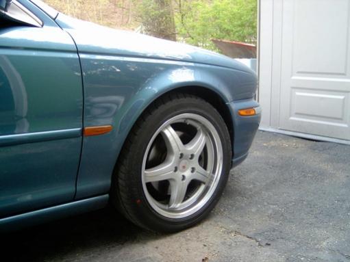

Here's what they look like - 17 inch with 225/45's
