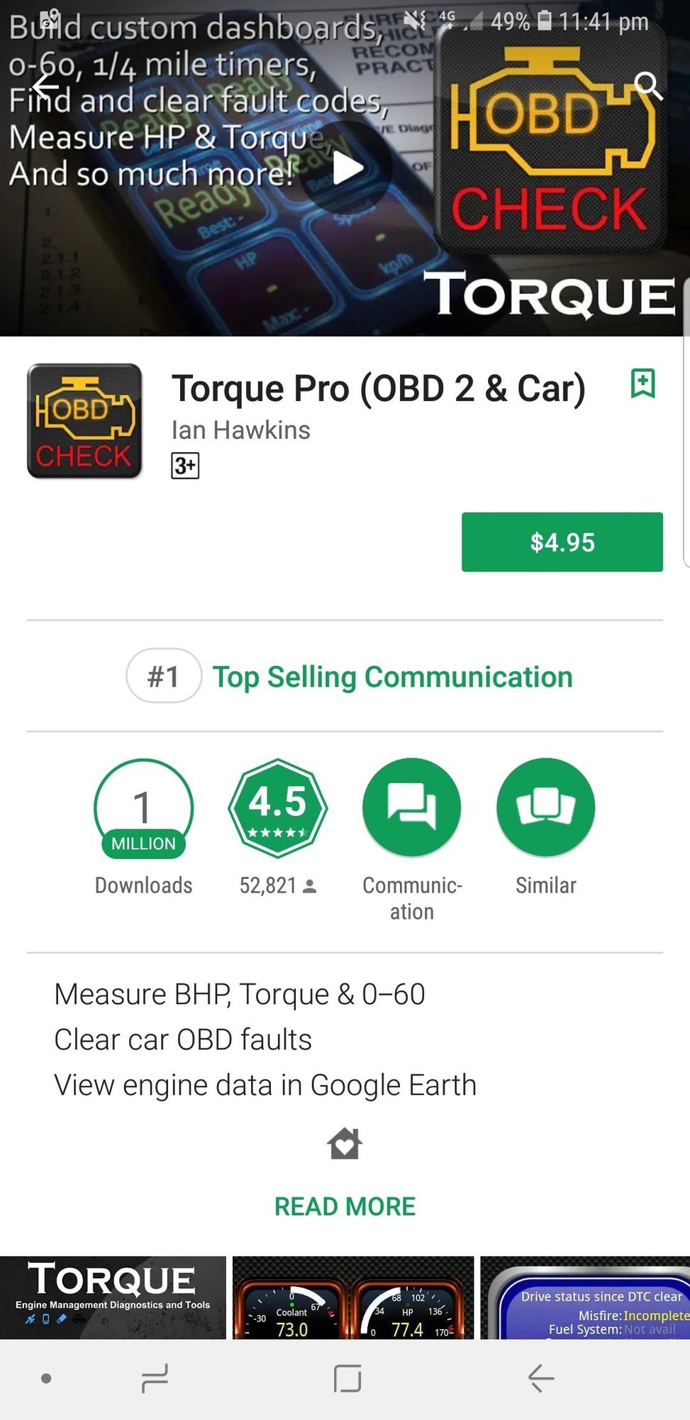

It would be money well spent to get yourself a code reader and check yourself. Or there is is an app for your phone called Torque that a lot of people use. Very good and inexpensive. If you could read the codes yourself, clear them and then see what comes back and then post them here I'm sure it could be easily diagnosed. If it is a vacuum leak(s) chances are they are cheap and easy fixes often times. Or do a search of what comes up and chances are there would be a number of threads about it. These cars have been around a long time now and pretty much anything that can happen to them has been discussed here. Sounds like you are kind of spinning your wheels on this right now.
