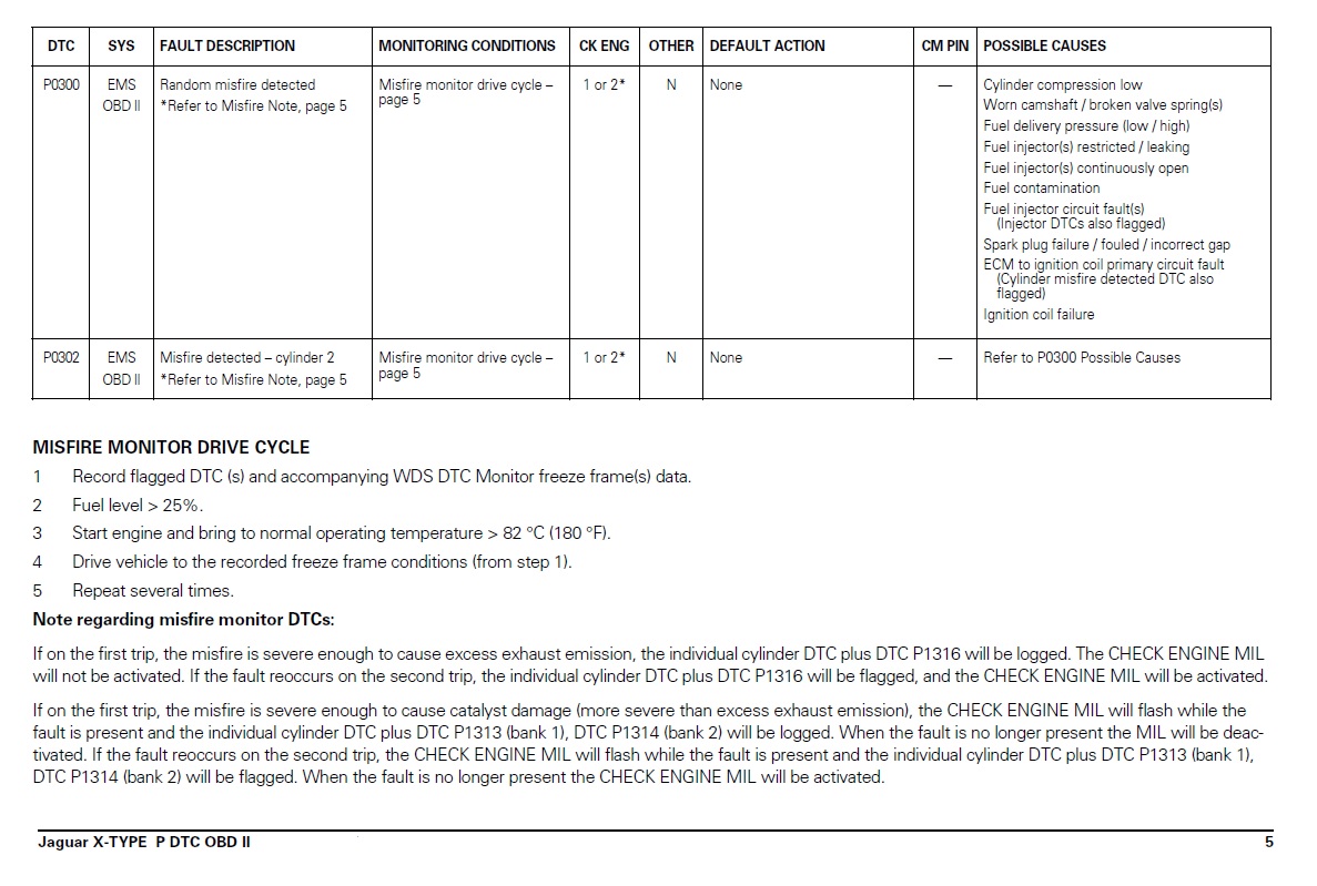

You've eliminated compression and coil but Code P0302 can be fuel related:
This is the full list of possible causes from the Jaguar DTC listing. I've included the notes on misfire monitoring.

The P1316 code does appear too.My brother Charlie talked to another Mechanic that knows Jaguars too that is a good friend of his.Said it is fuel delivery system related.Luckily I did not drive it and Charlie said that is a good thing,did it in my garage starting it up
