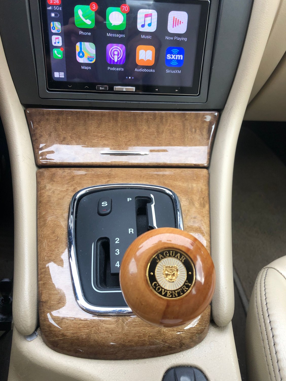

I agree with others that going to the original system is hardly an upgrade, probably the opposite . I am grateful my car had the standard system and I have been able to upgrade relatively pain free to my wireless applecarplay configuration
