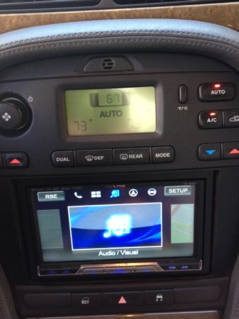

One of the Forum members did this swap that I might be doing on my Wife's X-type.

If you are going from the factory non-NAV radio to the factory NAV radio, you will have a lot of upgrades that you will be forced to do. In short, you are going to be ripping out most of the dash to install the automatic temp control system that is part of the Nav radio as you won't have the space for the current controls that you have. You will also need to install a lot of other modules throughout the vehicle to make the NAV system work properly. For what you are going to spend, it is going to be cheaper and much, much easier to go with an aftermarket radio to get the NAV feature in your vehicle.
Can it be done. Of Course!!!!! But, are you willing to do what it will take and what it will cost to do that?
