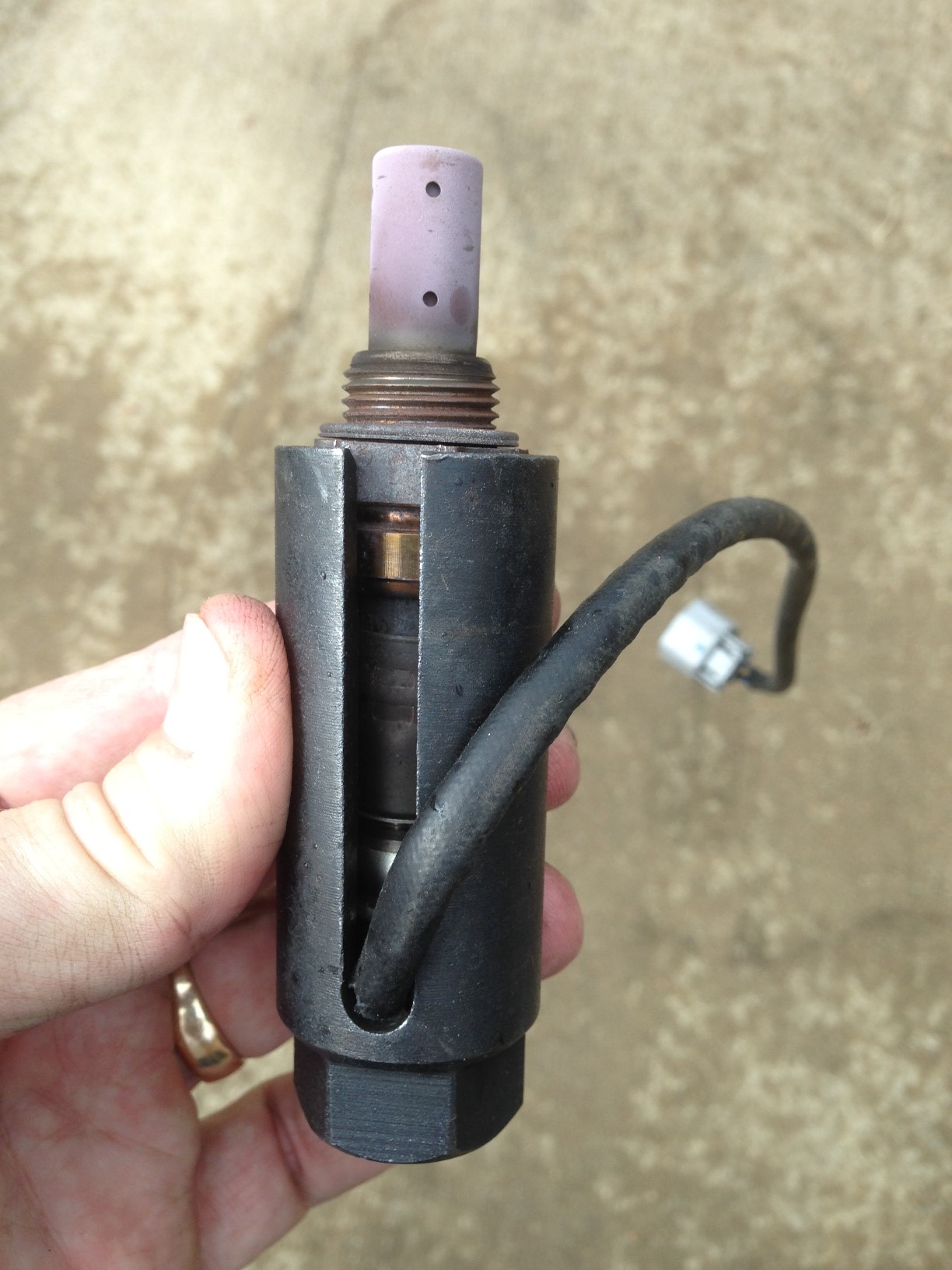

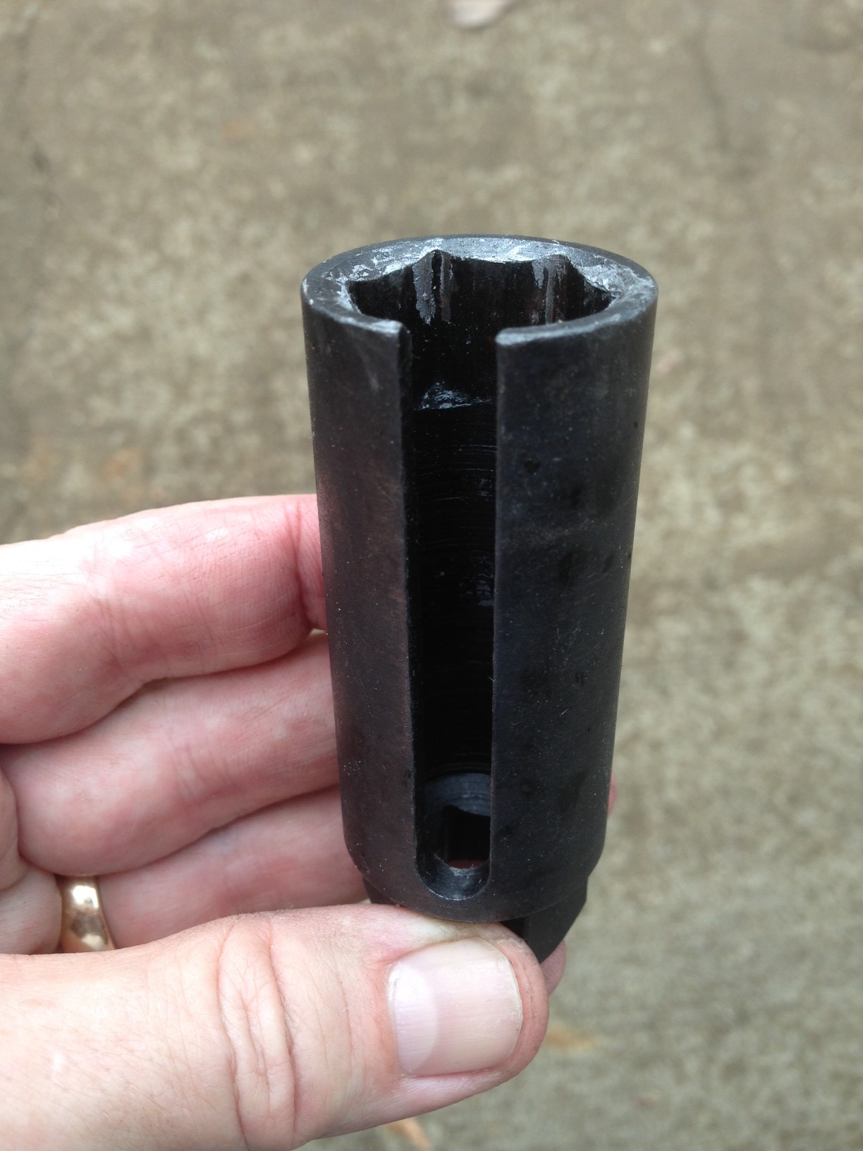

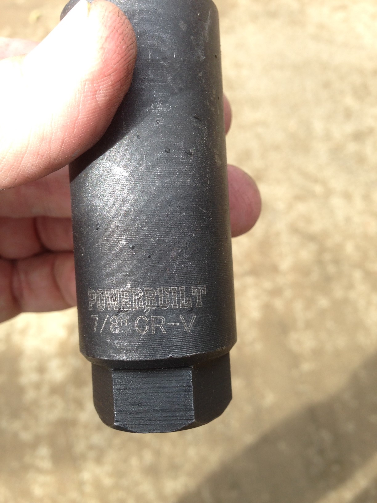

Voltage, it is advisable to get a "oxygen sensor socket" as it has a slot in the side to allow you to run the wiring out to the side so you don't damage the wiring. Your local auto parts store should have a kit that he can rent (most do it for free, just have an initial deposit you put down on the kit, but you get this back when you return the kit). That will have everything he will need.

Voltage: Here are pictures of the special socket your husband will need to remove and install downstream oxygen sensors. As Thermo suggests, when you buy new sensors, ask the auto parts store if you can borrow an oxygen sensor socket, usually for free with a small deposit.

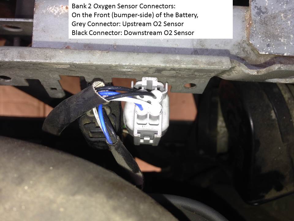

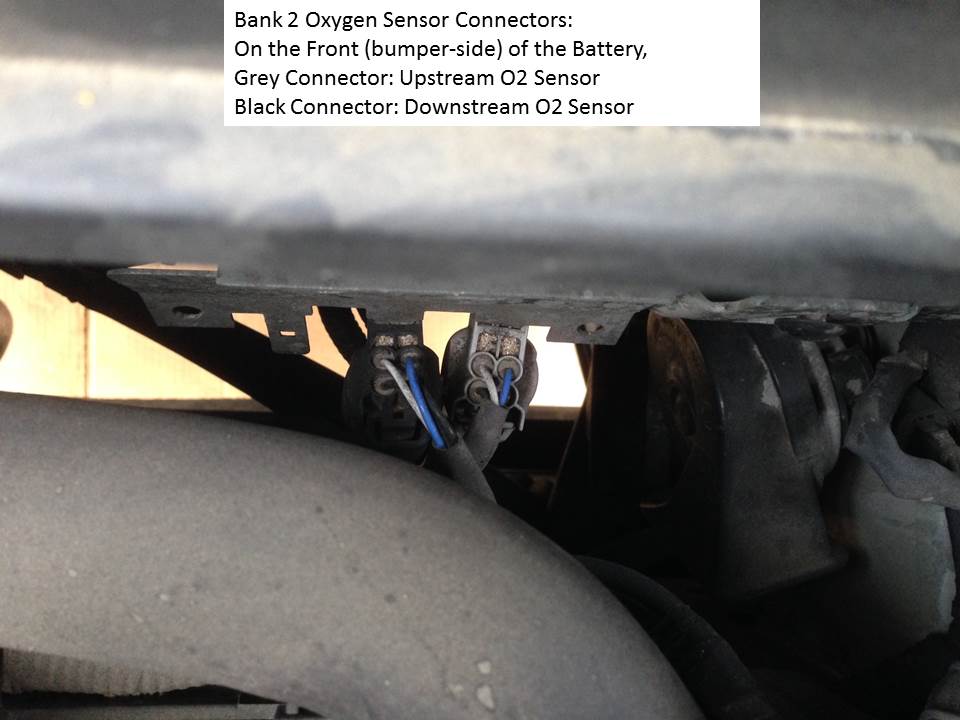

The downstream sensors have a black electrical connector, the upstream sensors have a grey connector. The black connector and grey connector are located next to each other in two places:
+ Stand by the front bumper and look down on the front-side of the black battery box, i.e., the side of the battery box that's closest to you. On the metal bracket holding the battery, you should see a black and a grey electrical connector next to each other. These are for the catalytic converter on the radiator-side of the engine (aka Bank 2).
+ Stand by the driver-side wheel and look just to the left of the brake master cylinder (where you add brake fluid). You should see another pair of black and grey electrical connectors next to each other and attached to a small metal bracket. These are for the other catalytic converter on the firewall / passenger compartment side of the engine (aka Bank 1)
From beneath the car, your husband should be able to follow the wires from each of the black (not the grey) electrical connectors to the two downstream oxygen sensors on the two catalytic converters.

voltage: Here are some pictures to help your husband locate the electrical connectors for the oxygen sensors. Assuming your car has the same black & grey plugs, he can disconnect the black (downstream) plugs, then follow the wires to the downstream oxygen sensors located at the bottom / output of each catalytic converter.
