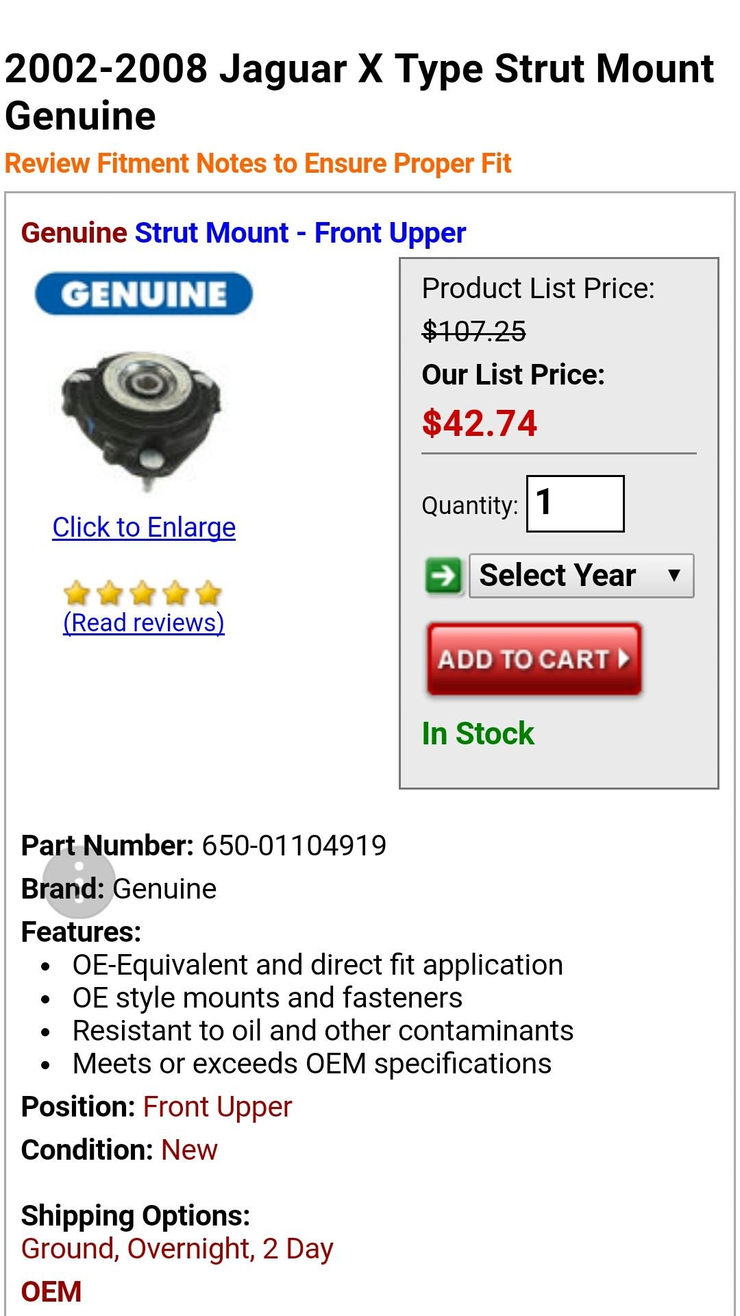

Could it perhaps be strut (bushing or loose mounting plate)? Or struts failing?
Old Jun 23, 2018 | 04:38 PM
Dell Gailey's Avatar
Joined: Mar 2017
Posts: 4,772
Likes: 795
From: Utah
This part =

+1 to possibly a bad rubber bushing in the strut mount, which comprises a rubber bushing and a bearing:
  • The rubber bushing cushions the strut rod from the strut tower. When it's hard and compressed with age, the strut clunks over bumps. To test, find a speed bump you can hit one tire at a time and listen for a clunk as you drive over it at ~5-20 MPH (depends on the car and size of the speed bump).
  • The bearing rotates +/- ~45 degrees as the front wheels & strut assembly turn right / left. A bad strut bearing won't turn freely, so the strut clunks when the steering wheel turns wide swings. To test, turn the steering wheel lock to lock at ~5 MPH in an empty parking lot.
If you replace the strut mounts, consider replacing the struts also, since both must come out for this repair.

That part also moves laterally as wheels are turned (i.e. Pothole tries moving wheel left/right). All else having been checked and eliminated, I'd still guess the strut mount/bearing. You can have someone sit in the car and turn wheel lock to lock while looking at the top of the strut under the hood to see movement. I just don't think you can get it to move sideways fast enough doing that to see/hear it hit.
