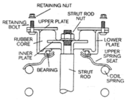

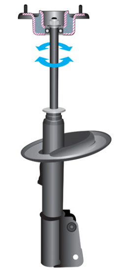

A clunk noise from high mileage struts is more likely from worn strut mounts, not from the struts.
Inside a strut mount is a rubber core that holds the end of the strut rod, i.e., the piston end of the shock absorber. After umpteen thousand bumps in the road, the rubber gets stiff, and big road bumps "slam" the inner plate of the strut mount into the upper and lower plates, with a tell-tale "clunk".
Suspension done and redone...stop clunking!!-strut_mount.png Suspension done and redone...stop clunking!!-strut_mount2.png
Additionally, the rubber in the strut mount must flex with every turn of the steering wheel. Watch how much stress this puts on the strut mount rubber at the end of this ~3 minute video.
When they begin to clunk, it's time for new strut mounts.
